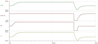

    As long as we don’t violate the “VCAP to A” 85V Abs Max, we should be okay. If we can discharge VCAP-VS very quickly, then the problem is solved.
    Using a PNP and some passives, we can discharge the VCAP when Vin goes from 36V to -40V. Please see circuit and simulation results below.
