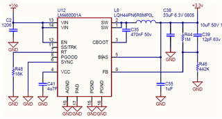

We have an a few percent of boards failing in the field in the same way as described in the related thread.  It appears that the ability for VIN to provide the initial voltage to the LDO  in broken.  If we provide 3.3v to VCC momentarily the device starts and then functions as normal.   Our application is 24v down to 3.3v with around 400ma load. The 24v is derived from an LM46000 operating from 48v.  We have checked that Vout > Vin during shutdown and we do not believe BIAS can be > 30v nor VIN > 65  volts.  Since the previous question is marked resolved do you please have a likely candidate for this failure mode.

    It looks like you are setting the switching frequency at 2MHz for the 24V to 3.3V conversion.
    I believe this frequency is too high for this conversion, given the minimum Ton time of the part. Please check equation 6 on page 21 of the datasheet.
    You should update the switching frequency and component values to cover this conversion range. You can use webench to get initial BOM component values for this design and update the corresponding components (Rt, L, Cin, Cout) in your design.

    Thanks for the feedback , I appreciate that the switching frequency is not optimum and I will change it on future production.  However my question is about a specific failure mode that has also been experienced by other users in the related thread.
    I would be grateful if you could address the issue of the damage that prevents the LDO from receiving its supply from VIN.  This fault has occurred to around 5 units in 500 over a period of 2 years.  The other 495 are still working ok.
    We suspect something in the system is the cause but we need to understand the vulnerabilities of the LM46001 to figure it out.

  • It seems in both cases the device VCC is getting power from VIN as in the left case, vout=vbias is below vbias,rising-vhys and in the right case, bias is ground.
    It seems in both cases the output is below set point.
    From the above waveforms, it does not seem to demonstrate device inability to power from Vin?
    It does seem that device is not regulating...would you like me to review the schematic for stability concern?

    Do you have any belief that something might be back powering the device or causing the absmax on vbias to be violated?
    TI might need to request a quality analysis be done on these units if we find nothing wrong with your schematic.
    It seems that LDO has become damaged in this unit.
  • Hi Marshall
    No worries , yes I agree the part has become damaged.  I read somewhere else that VOUT > VIN can be a problem so i have done some tests on the board and have not found that to be an issue.  It seems to me the candidates are VIN and BIAS but they have a tolerance of 65v and 30v which are both much higher than voltages present.  I was hoping you might be able to narrow it down  by understanding which part of the internals has blown and hence which pin we should concentrate on.
    The 3.3v powers a PIC through a diode and 3 TMS320 processors.

  • My gut reaction would be the bias pin.
    You can do an impedance check...A-B comparison between control and fail.
    If failure did occur, it may not necessarily be evident at the pin.
