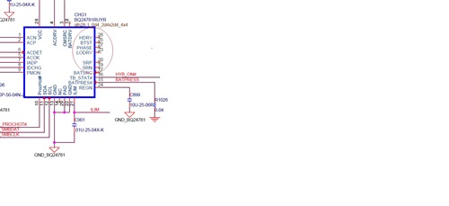

BQ24781 schematic check
Other Parts Discussed in Thread: BQ24780S
Hi Sir,
is there problem with the customer schematic? these pin define not connected.
please kindly refer to the attached.
CHARGER_210311.pdf

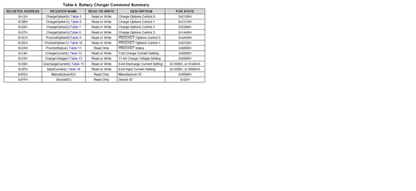

The data sheet that does not have CMD that can read Vin is shown in the following table. Is there a hid version of CMD that can be read? Thanks for your help
