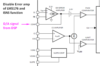

We want to know whether LM5176 can be controlled by DSP in parallel.
1) Disable Error amp of LM5176.
2) Short ISNS function
3) Give D/A signal to the comp pin of each LM5176.
Is there any sign impact? Or we shall follow SNVA792 and SNVA794 method?

    1) Could you please explain it more detail? FB short to Gnd directly or thru 10k. How about SS pin?
    2) What is COMP input range to control? Does the comp pin control by D/A signal? (I saw there is 1.6V in series path.)
    3) If disable FB function, may I put the external compensation as below picture?
    4) About your mention "negative current", is it sign impact while LM5176 disable FB/ISNS function? Is there any fixed way?

    1) FB to GND or through 10k: both is possible as it is a high-impedance input, I would add a cap to the SS pin as normal usage.
    2) You can check this on your circuit when the loop is still closed. Please make sure that you stay in the abs max rating range.
    3) Sorry, but the picture did not come through. Nevertheless, if you do not use the error amplifier, you do not need to compensate it in general.
    4) In closed loop operation, the device will push back current into the input when the output voltage is higher than it should be. I do not know how the device will work if you close the loop through COMP instead of the FB node. You need to control the COMP accordingly to prevent it, I think. The device does not have a DCM function, so this can happen. If you want to use a device that has a DCM then you might have a look at the predecessor LM5175.

    Finally, I found the relationship between Vcomp and Vout for LM5176 with disable error amplifier.
    Vcomp> 1.6V, the LM5176 is operating in boost mode. It need be careful the Vin is high level (48V or higher) during Vcomp>1.6V.
    But the problem is how to transfer in buck / buck-boost / boost mode.
    We are studying this whether it is ok or not for this idea.
