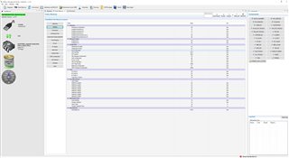

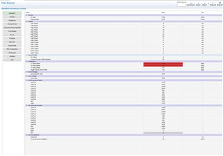

when checking the measured fet and cell temperature and checking with a thermal camera, we see at about 60°C about 5-10°C error. I've seen that our temperature model has still the default values, so I used your Thermistor Coef Calculator to recalculate the coefficients.
What is Adc0? The value at 25°C? So when I have a 10k NTC I have at 25°C an ADC voltage of about 1.65V --> ADC value = 2^14/3.3 * 1.65 = 8192?
When I change the coefficient (even to unrealistic values) the temperature do not change. Do I have to set anything else?
