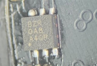

Hi Team,
Customer ask us the meaning of the characters in the top Silk screen. could we explain to them?
BZR--means?
OA8--means?
A4OP--means?
Hi Team,
BZR--means?
OA8--means?
A4OP--means?
Hi Amelie,
BZR is the device marking for the device. You could consider it as a short name for TPS61161. It could be found in datasheet PACKAGE OPTION ADDENDUM section.
0A8A4OP is the lot information, which indicate the which lot it was manufactured.
