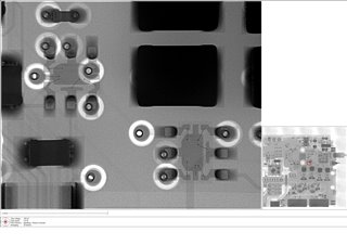

  • Ben,
    Here is another picture of U49 (G01 on the left) and U51 (G12 on the right) for the 2019 board.
    We also performed an x-ray on the 2019 part itself and we were able to get good enough magnification to make out the bond wires quite a bit better:
    Looking into the artwork now to see if we may have added some additional copper below the part in question that could be distorting the resolution. It's just difficult to believe anything additional that was added wouldn't have affected U51 as well.
    Ryan

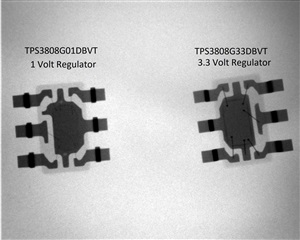

  • Ben,
    This is an image comparing the 1.0V supervisor to the 3.3 V supervisor at the same magnification just laying the parts in the x-ray machine with no circuit board present. Notice how thin the bond wires are on the 1.0 compared to the 3.3.
    We are working on trying to get lot code from parts today.
    Ryan
  • Hi Ryan,
    Thanks for the photo!  Very interesting.  I will forward this information to our backend people and see what is their response.
    Ben
  • Hi Ryan,
    I think I have found your answer.  The difference between the "G01" and "G33" is the difference in bond wire material.  Certain bond wire material shows up more profoundly in the x-ray than the other material.  The materials used in the bondwires can be gold, copper, etc.  The x-ray may show that the bondwire thickness to be different between the two parts but both have the same thickness or diameter.  I hope I have answered your question.
    Ben
