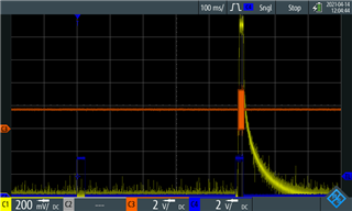

There is an example of the power off sequence for 1.5V rail with the "Fast Over Current Fault Limit" exceeded (CLF flag set):
There is the power off sequence with "Fast Over Current Fault Limit" set to 9.0A (no CLF flag):
Ch2 is the voltage at the IMON2 pin and Math2 is the output current calculated as (U_IMON / 10kOhm) / (20uA/A).
Ch4 is the current measured across the J7 jumper:
IMON voltage for the same rail at another board (250mV_pk equals to 1.25A_pk):

    During the active ramp-down (soft-off), the UCD7242 is not capable to report the correct current. There are actually a couple of older posts on this forum which are mentioning this. I'm not sure if your channel 2 waveform is inverted (IMON), but typically the inductor current should actually be going negative during the TOFF FALL period.
    To overcome this issue, I would suggest to either:
    1- Use Immediate-Off in the configuration (set through Rail Config > On/Off Config). This will make the controller stop regulation, instead of try to switch all the way down to zero in closed loop.
    2- You could try to increase the TOFF FALL time to reduce the overall negative current amplitude
    That waveform is not inverted. Both Ch2 (IMON) and Ch4 (current probe) show similar positive values with higher load currents, and Ch4 (current probe) confirms that the output current is going negative during the TOFF FALL period.
    Unfortunately there is no significant reduction of the peak IMON voltage with the TOFF FALL time increasing.
    When I have increased this time from 5ms to 15ms the negative output current has reduced about 3 times (~70%) but the IMON voltage has reduced from 8.7A to 7.2A only (~17%).

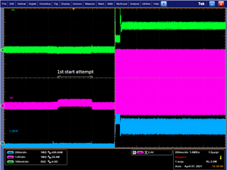

    SW node (the SW-B pin of the UCD7242) waveform (Ch3) with IMON (Ch2) during two consecutive start attempts:

  • Matt,
    I use 1:10 probes (10MOhm/8pF) so there is no significant loading.
    PWM node waveform (Ch3) with VOUT (Ch1) and PMBus_Cntrl (Ch4) during two consecutive start attempts:

  • Is there any cross-rail leakage here? Trying to understand why the output voltage went up 200mV without any PWM pulses.
  • Yes, it certainly is a cross-rail leakage. There's the same stuff with the only 1.5V rail enabled - without any leakage:
