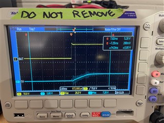

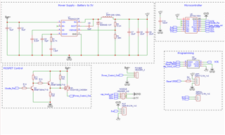

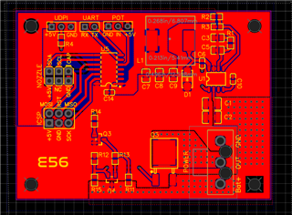

Hi there for some reason I've had two of my power converters fail either as the Vin pin blowing up or the output short-circuiting inside of the IC. I am running this off of a 20V battery and regulating it down to 5V. I will note the battery is connected via a switch that controls power to the whole board. The system seems to work at first, but after turning the system on and off a couple of times it fails. I based all of mydesigns around the design tool, so I'm not really sure what's happening. Here is my schematic, PCB Layout, and simulations

    1. I review the schematic, the problem is at C6, it should be 100nF, not 10nF.
    2. D1 is very small, does it can bear 3A loading?
    If still have problem, suggest probe some waveforms including Vout, PH, inductor current when issue happening.
  • I noticed that before doing my testing and replaced that capacitor. Also, my diode is rated for 3A. I'm hoping to get access to an oscilloscope soon, but I'm hoping there are some suggestions about where the issue is coming from. Would a transient on the Vin cause the output to short circuit?

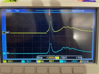

  • Hi the issue has been resolved. Due to inductances of longer wires coupled with the low input capacitance as well as some switch bounce, there was some oscillation on the input. This created spikes that reached >40V which would blow up the IC. By increasing the input capacitance to 150uF (could possibly go lower) the issue was fixed. Ignore the blue waveform in the spike picture as it was hooked up to the same spot as the yellow
