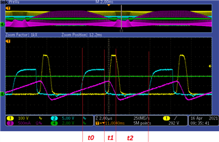

If I understood this correctly I then can't understand the measurement I have done below;
In the measurement snapshot a few cycles can be seen at 230Vrms at the bottom of the input voltage (~180 deg). The on time is close to the maximum specified of the datasheet (~5.28 us). But I do not understand how this is made in the calculation of the on-time.
Here ton = 5us, toff = 900 ns and Tdcm = 0. Which gives dondch = 1. How can the on-time then be more than gff(6)*Tonmax0 = 13.2*0.158 = 2 us?
And for this specific case if I also plug in the comp pin voltage in the equation the calculated on-time should be according to the equation below;
Vco = 3.36 V, Vcomax = 5.7 V, gff = 0.158, Tonmax0 = 13.2 us, dondch = 1 -> Ton = 1.23 us

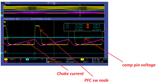

  • Hello Ola,
     thanks for your interest in UCC28056.
    Does the waveform captured on UCC28056EVM, or do you do any change on the schematic compare to the EVM?
    I suggest you test the Vgs instead of testing VDS.
    at 230VAC input, Vco=3.36V, the controller should works at DCM with Tdcm not equal to 0. you can refer to the Figure 18 in the datasheet.
  • Hello Ulrich and David,
    Thank you for your detailed replies. As you said the trick to see what is going on is as you said to measure the DRV signal and not only look at the drain voltage.
    By looking at the similar operating point It is visible that the on time should be as the formula describes. But not with Tonmax(X), x=6, are you certain this is the case? The calculated on-time at 230 Vrms (gff=6) checks out with Tonmax0. See below;
    to= 2.2 us, t1 = 0.7 us, t2 = 2us
    -> dondch = (2.2+0.7)/(2.2+0.7+2) = 0.59
    Vcomp = 3.36, gff =0.158, tonmax0 = 13.2 us
    -> Ton = 13.2/0.59*0.158*3.36/5.7 = 2.1 us
    It also matches at high line of 230Vrms
    t0 = 1.5 us, t1 = 8 us, t2 = 2.7 us
    -> Ton = 1.59 us (gff = 0.158 and Tonmax0 = 13.2 us)
    I would suppose the Tonmax1-7 is just there as a safety mechanism then and has nothing to do with the calculation of the on time?

  • Hello Ola,
    Thank you for probing Vg and for your additional calculations.
    It appears that Ton is indeed dependent only on Tonmax0 and not on Tonmax(X) regardless of Gff(X) levels.
    I was not certain of it, but came to that conclusion while trying to fit in a smaller on-time without knowing what it actually looked like, and trying to justify why the additional Tonmax(X) parameters are specified.
    If they are not useful in the Ton(theta) calculations, then I suppose they might simply be a safety mechanism as you suggest.
    Certainly, the Tonmax(0) term alone makes the calculations match the actual DRV signal timing.
    Given this result, I think this thread can be closed.
