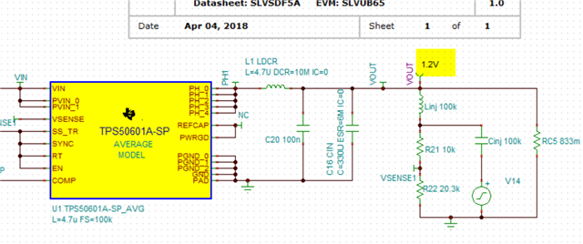

  • Hi Praveen,
    Thanks for the response. My customer however is still wondering how to be sure that the other parameters of the model are well updated? Can you confirm that there are no parameters that would still be set to the “old” values?
    Moreover, they suspect the TINA average model to have the same problem. As you can see in the picture below, running a DC analysis leads to a wrong output voltage. Can you kindly check this model as well?

  • Hi Obinna,
    We have verified and updated the WEBENCH model parameters for TPS50601A-SP as per the datasheet. Updated Model will be available on ti.com by next WEBENCH release(Tentatively by 3rd week of May).
    For average TINA model, we observe that the Vref set is 0.8V instead of 0.804V. We have requested for the model update. For immediate reference, please find the attached TINA model with updated reference voltage:
    slvmcm4.tsc
    Vout is 1.2V:
