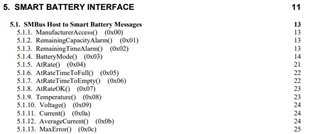

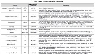

I made a smart battery using the BQ28Z610-R1. However, I receive strange data while communicating with the CPU. If you look at slucc81-57 page, there is Standard Commands, which is different from Smart Battery Data Specification. What is the standard command of BQ28Z610 based on?
