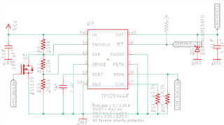

I have an eFuse TPS25944A (the auto-retry version, reference confirmed with the device marking) which controls a power path (see schematic below):
  • Vin = 5 V;
  • Ilim = 2.16 A (Rlim = 41.2 kOhm);
  • UVLO / OVP resistors;
  • Cdvdt = 1 nF;
  • Cout = 1uF.

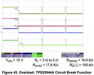

The eFuse works as expected in normal condition but when an overload occurs (tested with Iout=2.5 A < Ifastrip), the output is latched off and no auto-retry is done. Then, the device do not switch on the output when the load falls below Ilim. It seems to me this is approximately the TPS25944L behavior, the TPS25944A should auto-retry according to its datasheet and the figure 43:
Can somebody explains me where is my mistake(s)?
Thanks !

  • Hi Arnaud,
    Thanks for reaching out!
    Your UVLO, OVP thresholds are close to nominal VIN. Can you check whether the device is still in UVLO or OVP events ? Can you remove R12 and test again.

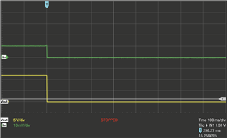

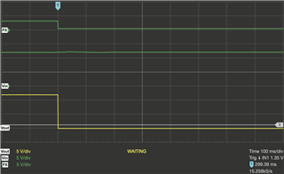

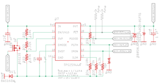

    I think UVLO/OVP are not the problem: the same board contains 3 other eFuses which don't auto-retry after overload (same problem). They control +12V power paths with more larger thresholds: UVLO = 8 V, OVP = 15 V. Their schematic is below (an input reverse polarity protection is present. Do not mind the peculiar usage of PGTH).
    It is simpler to test the +12V eFuse. I can't graph any current for now but the others waveforms are here:
    I triple checked the device marking but it seems to be a TPS25944A...:
    May these informations help to understand the problem...

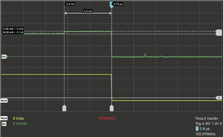

  • Hi Rakesh,
    Here are the requested waveforms: they show Vout and Iin. The first has the same scales than the waveforms from my previous post. The second displays time/voltage/current cursors.
    Do not mind the current value precision: it isn't exactly the eFuse input current but the board current, a small offset was recorded.
    May this help !
    Arnaud Puret
  • Hi Arnaud,
    Thanks.
    It is showing TPS25944L (latch version) behavior. Where did you bought these units? from distributor ?
