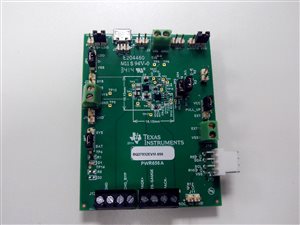

I've acquired this EVM because I was interested on low footprint area and the possibility of using just a I2C interface to access both gauge and charger.
The problem is that somehow the I2C interface used between BQ27532 and BQ24250 seems not be working. On the board there are 2 jumpers, JP4 and JP5 connecting the I2C clock and data pins. These jumpers are connected, and as I understand, it's the only setup needed on hardware.

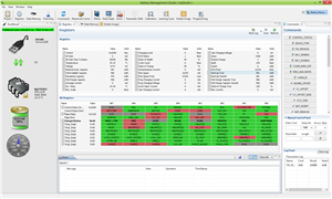

Operating the BQ27532 software, I see that the ChargerStatus register is always with ERR bit set (bits WAIT_CMD and WFAIL change accordingly). I tried to enable/disable the charger I2C interface several times (GG_CHRCRCTL_ENABLE / GG_CHRGRCTL_DISABLE), but nothing happens. I've already tried to communicate directly with BQ24250 charger using another I2C adaptor (unplugging JP4 and JP5 off course), and it works normally.
Is someone there having the same problem?
