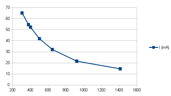

  • Here's an update. I have measured the no-load power consumption (mA) versus the frequency (kHz).
    Now this makes me think that the primary inductance is not enough for 350 kHz.
  • I have tried increasing the inductance. I think this was the case.
    If you can suggest anything else to increase efficiency at 350 kHz, please do.
    Thanks.
  • Hi Peter,
    I think the higher inductance helped in this case because the TPS55010 had to sink less current during each switching cycle. This lowers conduction losses on the low-side FET.
    Another tip to boost the efficiency with the TPS55010 is to ensure there is enough leakage inductance in the transformer to allow zero voltage switching to reduce switching losses. When the low-side FET turns off there is some delay until turn on of the high-side FET. The leakage inductance causes the SW node to ring. With enough leakage energy it will ring up to the input voltage the same time the high-side FET turns on.
