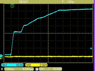

    I know for sure that on the second failure the 12V output was discharged. The oscilloscope doesn't show any ringing on the Vin at power up (a file of the oscilloscope output is attached). Since the large input capacitors in the Vin as you can see on the second schematic ( 8 x 680 uF ) I have start using a precharge circuit from the last few days to reduce the huge initial pick current and also avoid any ringing.
    I hope these changes are sufficient to prevent further failures. While I have concerns about the high capacitance in the 12V side and high energy demand is needed at start up so therefore a soft start in the buck converter should be necessary. What do you think about it?
