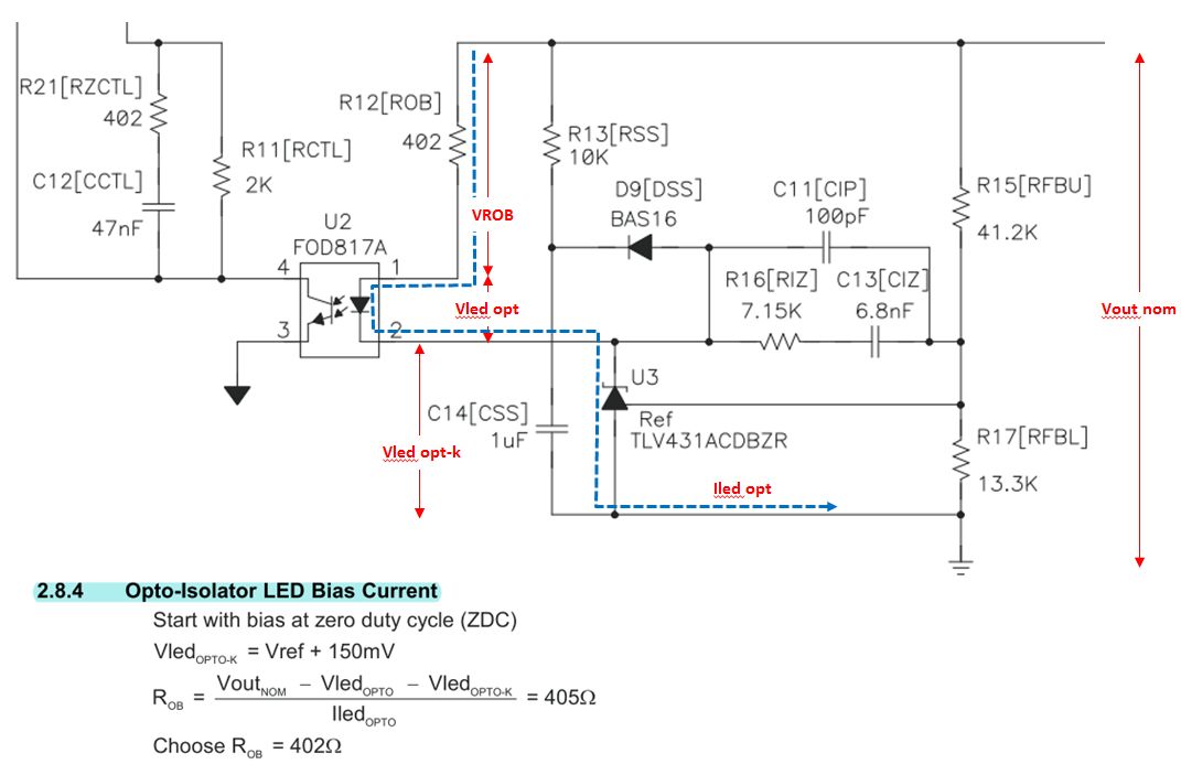

Please answer following questions about “SLVA305A Designing with the TPS23753 Powered-Device and Power Supply Controller” application note from customer.
-P12, 2.8.4 Opto-Isolator LED Bias Current
Please advise what is the “150mV” of following equation.
  Vled opto-k = Vref + 150mV
Best Regards.

    Pleas answer additional following question about Vled opto-k.
    Please refer following figure that my understanding is added.
    Q1:
    I think “Vout nom – Vled opto – Vled opto-k” in chapter 2.8.4 ROB equation is voltage drop of ROB and Vled opto-k is voltage drop of TLV431 Cathode to Anode.
    Please answer if my understanding is correct and Vled opto-k is voltage drop of TLV431.
    Q2:
    My understanding of TLV431is that VREF to Anode Voltage is 1.24V but Cathode to Anode voltage is differ form VREF to Anode Voltage.
    Please advise why Vled opto-k is calculated from Vref + 150mV.
    Best Regards.
  • The main objective of this section is to choose Rob based on the target LED bias current. For the shunt regulator (TLV431), Vk = Vcc for the device and Vk-minimum = Vref (see first two feature bullets in the TLV431A DS, SLVS139U)

    In the design app note, you can set Vled-opto-k =Vref if you want to but I had chosen not to operate the shunt regulator all the way down to Vref and as such added 150mV.
