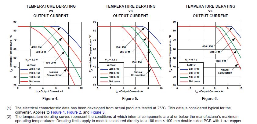

What is the maximum power consumption for the PTR08100W part?
Jojo
Jojo
Jojo:
I attached the power dissipation and thermal derating limits for PTR08100WVD.The thermal data is directly related to output voltage versus output current and airflow.
The power dissipation from the data sheet is:
The thermal derating limits for the PTR08100 which is solderfed into a 100 mm x100mm double sided PCB with 1 ounce copper.
Thermal data from the product specification is
