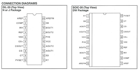

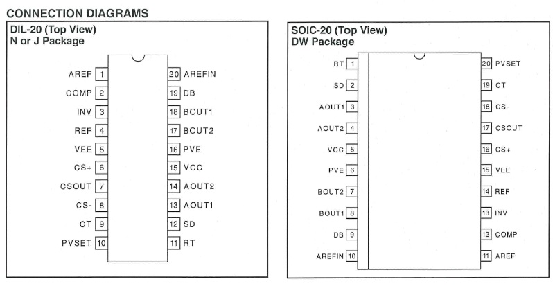

In the UC3638 datasheet, the pin function description looks not consistent for SOIC-20 DW package and DIL-20 package. It looks like SOIC-20 DW package pin descriptions are not correct. Anybody can double check and confirm?
