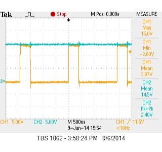

  • Hi Wei Chong,
    You mentioned:
    Koh Wei Chong said:
    Ven is about 6.4V
    Unfortunately this is beyond the Absolute Maximum Ratings specified on page 2 of the datasheet. Because of this, I may fear if the part has been damaged.
    You also mentioned:
    Koh Wei Chong said:
    I noticed that this chip (circuitry) has caused the overall power consumption of my board to increase. ( When I disabled the chip the current drops significantly). Could faulty/wrong inductor be the reason?
    If the part is damaged, this may cause increased power consumption. What was the power consumption before and after turning the device on? What do you have connected at the load?
    Can you post your schematic and scope shots of Vin and SW pins (also FB pin and Vout if you have a 4 channel scope)?
    Alex
  • Hi Alex,
    Please see below. Blue is Vin and yellow is Vsw.
    The schematics.
    Power consumption Before w/o turn on is 1.26W after turn on is 3.78W, without loads.
    Thank you for your assistance.
    Wei Chong
