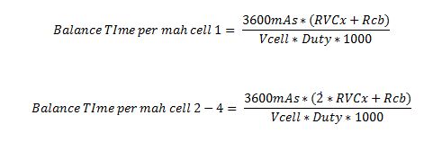

I'm currently trawling through the settings to configure my BQ40z50 for use with my cells. I'm intend to use the internal cell balancing and have got to the "Bal Time /mAh Cell 1" value. I'm not convinced my value is correct. For a cell with nominal voltage of 3.65V, I get 16274 which seems much larger than the default value of 367. Is the formula correct (is my calculation correct)?
Vcell = 3.65; RVCx = 100; DUTY = 66; Rcb = 150
I suspect the formula isn't quite right as the V/R portion gives a result in Amps which is the used to divide a value in mAs.
Additionally, the datasheet says Rcb is max 200 but the Tech Ref says to use 150.
