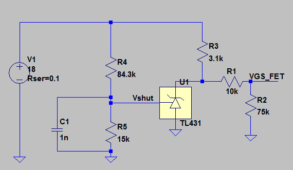

we are using TL431 in comparator mode. It is only mentioned that VKA is ~2V.
1. I would like to know the contributing factors of VKA variation.(in comparator mode with Vref>2.5V)
2. when the Vref > 2.5, the NPN transistor conducts and draws more current from the Vref pin. How is this going to impact the output voltage?
