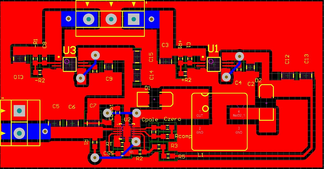

I have put together an eval circuit of the TPS7A4901, and with the exception of resistor orientation I have followed the PCB layout example of Figure 36 on page 20 of the data sheet, and the circuit diagram from Figure 9 page 12 of SLVU405.pdf (TPS7A30-49EVM-567). I set up the feedback network to give me Vout = 15V.
When I apply  ~16.5V input voltage I get nothing at the output apart from an initial jump of the output voltage from about 5 to 10 volts and then a rapid decay to ~zero. If I remove Vin from the EN pin5, then the output shoots off to ~14V, and when I reconnect Vin to EN, the output voltage settles on 15V which is exactly what I want. The TPS7A30-49EVM-567 demo board gives the correct output voltage every time, as expected.
So why am I getting these results given my layout is as close to the recommended? is there something with this part I've missed? or something else I could do to sort it out?

  • Hi Ryan, thanks for getting back to me.
    Unfortunately I don't have the recourses to swap the chips over, but I can provide you with images of my layout, which is part of a project. Also Ryan I have looked at a couple of TI's designs and came across TIDA-0040, tidrfj9.pdf, and this doc shows a type of power good enable mechanism hooked up, not sure what its function is. Is this to fix a similar issue?

  • Hi Martin,
    Thank you for the layout snipits. I do not see anything that would cause your issue; however, we would recommend pouring GND under the device for the PowerPad to enhance thermal performance. Also I notice that you appear to have some leads on DNC and NC that while not connected to anything could act like antennas. Again these are suggestions, but unlikely to be the cause of your issue.
    I am not familiar with the TI design that you are mentioning and there may be a typo in your name as I was not able to locate it. Could you place a link in your next post? From your description though, adding a power good to an upstream device to trigger enable would help with sequencing; however, I do not see this affecting your application from my understanding of it.
    Is U3 in your design TPS7A30? If this is a negative rail, we have seen where some loads require the positive rail to come up before the negative rail in order for the positive rail to come up properly. It looks like you may be able to disconnect the load from the LDOs. Does your issue present without the load as well?

  • Ryan, I've included a pic of the PCB I have made, not the best photo quality I know.. Its not fully populated as yet, not until I solve why this LDO is not starting properly. Hope it clears up the design. The large solder blobs that are visible is where I connect Vin power.

  • Hi Martin,
    The enable circuitry in the TI-Design is being used for sequencing purposes.
    Thank you for the picture of your board. Due to the bare copper, your board is subject to leakage through flux. An unintended leakage path could easily cause the behavior you are experiencing.

  • Hi Martin,
    It looks like from the photo that the CNR capacitor is going from the NR pin (pin 6) to VIN instead of to ground, as seen in the layout.  This would create a dangerous voltage on the NR node because that node can be pulled all the way up to VIN when VIN is first connected.  Can you turn the cap. around, and swap out the part to see if that fixes it?
    Mike
  • OhNo,,,,, horrible tasteless humble pie. Can't thank you enough Mike for taking a closer look, God knows I though I had. Swapping the cap around did the trick, it appears so far the LDO still works, but I have another to swap out as soon as I get the right tools. I'm so glad you guys are there to help out.
