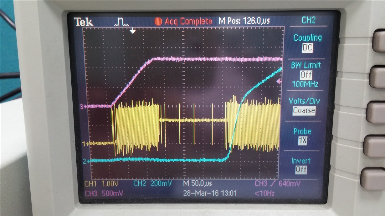

  • Hi Chris
    i re-test EVB in 5Vin/1.2Vout/1.2A start up condition.waveform as attached . CH1:Vsw CH2: output current CH3 Vout.
    i have no find the issue as customer provide. bur the output current is delay Vout around 200uS.
    May you pls help check my test waveform is correct or not?
    equipment : Chroma 63010(Load) TDS2013(OSCILLOSCOPE)TCPA00(current probe) E3634A(power supply)
                                                                  Bogey
  • Yes, this is another common issue with electronic load--they have some delays. This looks normal.
