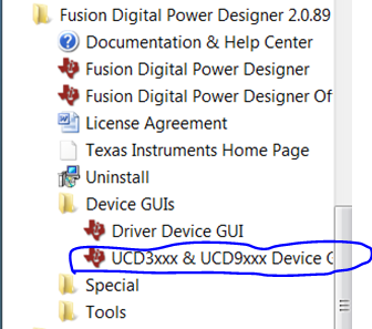

    I suspect that internal calibration data may be inaccurate. Could you help to export the trim data follow below procedure ,and send it to me for advanced analysis?

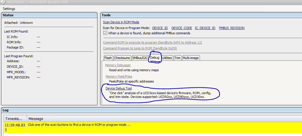

    [1] connect  UCD90120A  with your laptop, and open the UCD3XXX & UCD9XXX device GUI, show as below:

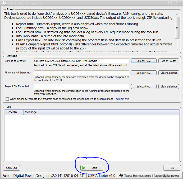

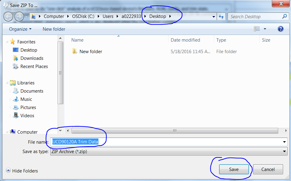

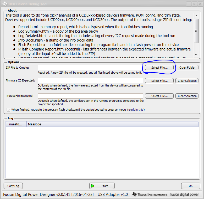

    [2] Press the link under Debug menu. Then press the "Select File" button to create a ZIP file, shown as below
    [3] Then press "Start" button, you will be asked for a pass code, type in "forestln" .

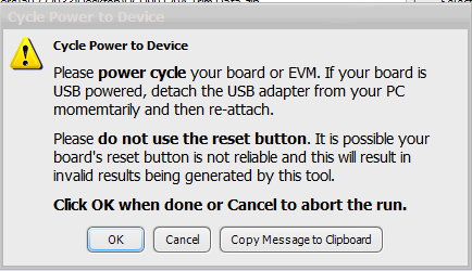

    [4] power cycle you UCD90120A  as below instruction,  then press "OK"

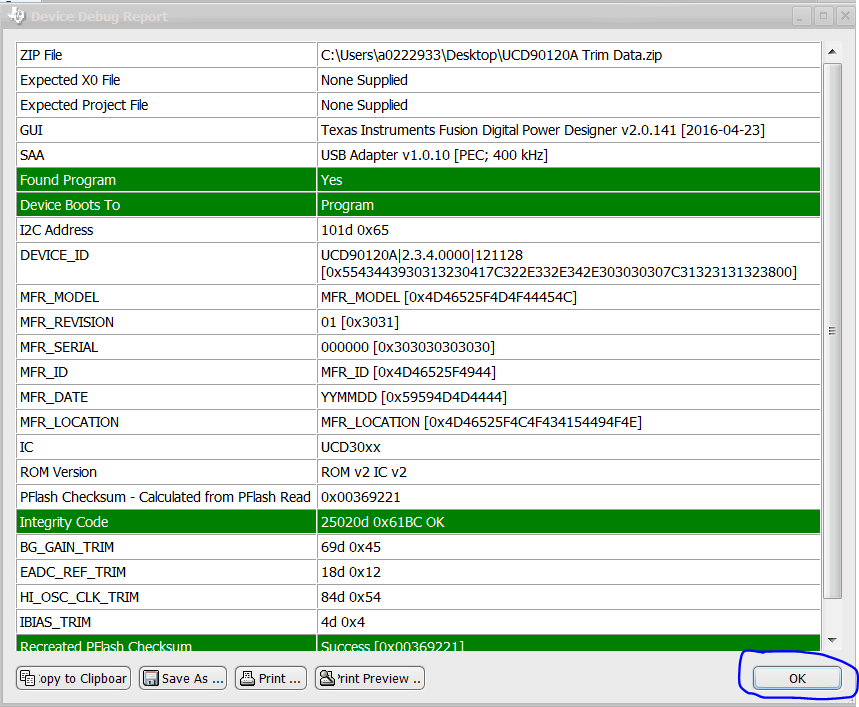

    [5] Wait for about one minute until below window pop up.  Then Press "OK"
    [6] Now you can find a ZIP file on your desktop. send it to me by email for advanced analysis.
