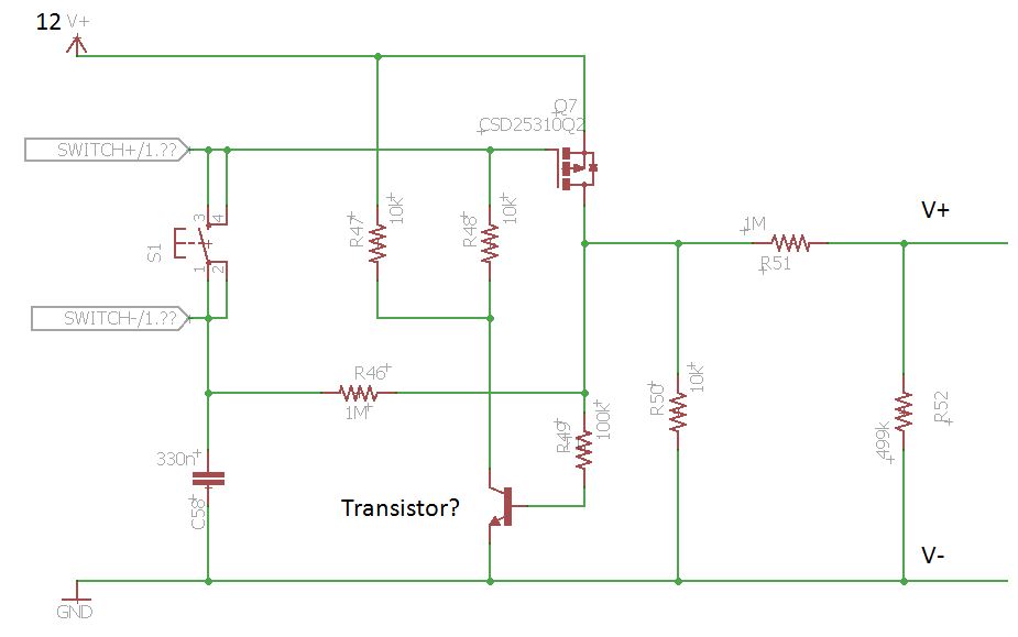

Hello all,
I'm trying to make a latch switch with a tactile button.
I read an article how to make this circuit from the link below and I think it's not too hard to follow.
<http://www.edn.com/design/power-management/4427218/Latching-power-switch-uses-momentary-pushbutton>
But I just want to check if CSD24310Q2 is a proper Mosfet to use in this schematic.
I have a 12V, 2A supply going into the whole circuit and since CSD24310Q2 is a rated at 20V, I think it should be ok.
Also should I use NPN transistor with a voltage rating same as PMOS that I'm using?
I'm not sure what parameters that I should look for NPN transistor.
