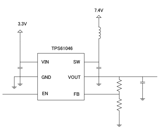

I have questions about TPS61046
my customer consider the design separating Vin from power stage.
Question1:
Can the device use in this usage?
Question2:
Can this device isolate between VIN and VOUT?
Question1:
Question2:
Takahiro-San,
TPS61046 can use seperate Vin. This usage is OK!
When it is disabled, Vin and Vout is isolated!
Sorry, I forgot one important point in my last post. the maximum voltage rating of the internal isolate MOSFET of the TPS61046 is only 6V,so please keep the power input voltage below 6V, or the device maybe damaged.
