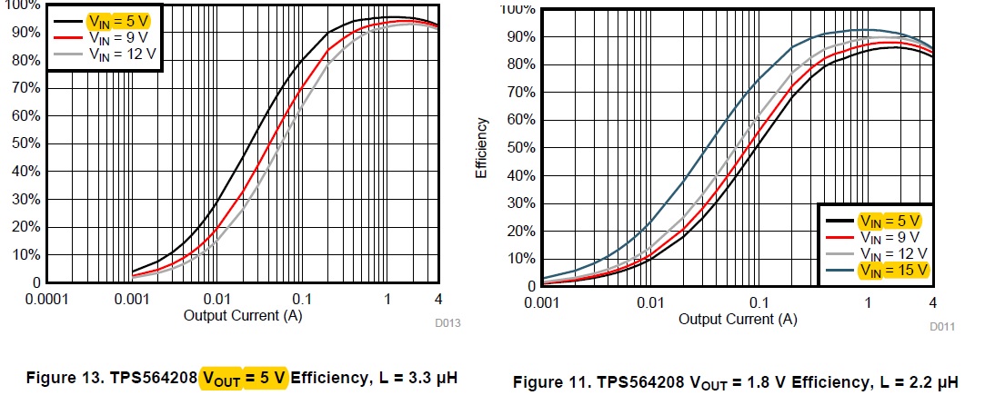

TPS564208 Efficiency question
Other Parts Discussed in Thread: TPS564208
Dear Sir
1. I saw the datasheet of TPS564208 ,17Vin to 1.8Vout/3A's efficiency is better than 5Vin to 1.8Vout/3A's efficiency ,is it correct ??
Generally 5Vin's efficiency should be better than 17Vin's efficiency
2. I think TPS564208 can't support 100%duty ,but figure13 show 5Vin to 5Vout's efficiency
