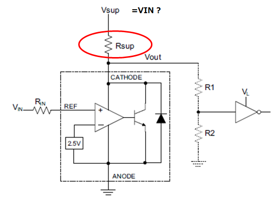

<Background>
・My customer uses this product for detection purposes for overvoltage protection.
・When overvoltage is detected with this product, it shut down the system with FET.
・So my customers consider the speed from Supplying 2.5V into Vref PIN to until the operation begins.
<Question>
 Data sheet (English version) There is a description of "Fast Turnon Response" in p1.
How is Fast Turnon Response stipulated?
 Example Request Answers
 - For example, it is test the start speed against this item and specify it ...
 - Since there is no delay on the design (or theoretical), if there is a worst case assuming XXX sec, there is no problem in design ...

    Sorry for the delay in response time.  There is a detailed example and explanation of using a shunt reference as a comparator in the TL431 datasheet in section 10.2.1 on page 23.     This example shows that the response time of the shunt is dependent on the current through the device, set by the external resistor between VIN and the cathode.  There is no maximum time listed because it is dependent on this resistor.  You may want to test out some resistor values to decide if you want a faster edge at the cost of Iq, or if you want to save some power with a slightly slower edge.  It sounds like you would like a fast edge, in which case I would suggest a smaller resistor.  You cannot make this arbitrarily small as you must not let the current exceed the maximum of the device. For the LM431, the maximum cathode current is 100mA.

  • Thank you for answering.
    the external resistance between VIN and cathode that's name is "Rsup"?
    Also, what I want to know is about LM 431, but can I consider it to be the same except TL 431 and cathode current?

  • Yes, sorry for not clarifying that. Rsup is the external resistor I was talking about.  The LM431 and Tl431 are functionally very similar, they can be used interchangeably, and both can be used in a comparator circuit.
