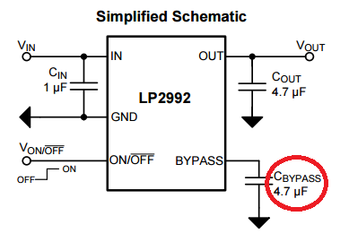

I would like to confirm just in case.
What is the recommended value of Cbypass?
10nF?
www.tij.co.jp/.../lp2992.pdf

Hello Seishin,
Thank you for bringing this to our attention. The 4.7uF value is excessive and is certainly not recommended.
The recommended maximum value for Cbypass is: 10nF (0.01uF). Please refer to Figures 16 and 17, and to the discussion in: Section 8.2.2.1.3 Noise Bypass Capacitor
This will be corrected to show Cbypass= 10nF in the next datasheet revision.
