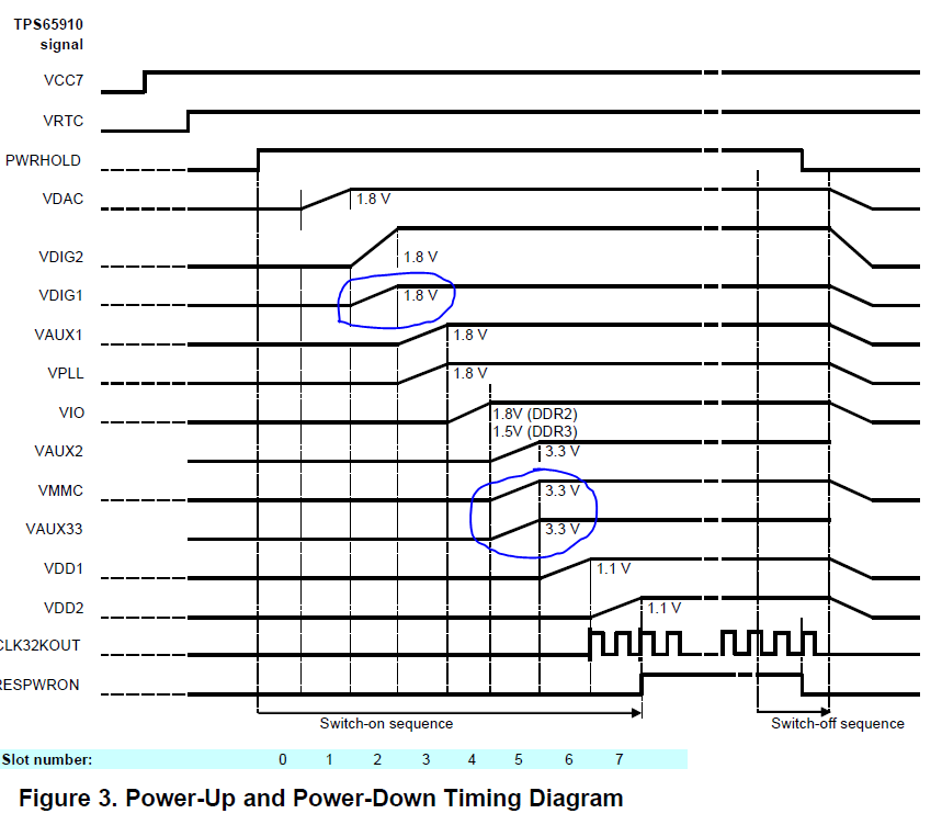

  • Kobayashi-san,
    What is the time scale of your scope shot? Can you attach a scope shot at 2ms/div? I noticed that your VAUX33 and VMMC are rising at the same time as VDIG1 when they should rise after the VDIG1. Attached is the timing diagram from the User's Guide.

  • Natasha-san
    Time scale is 20us/div.
    Attache waveform was TPS659108EVM, because VDIG1, VAUX33 and VMMC were started at the same time.
    My question is not start up timimg, it is start up behavier.
    Only VDIG1 and VDIG2 start up steeply, all other LDO's start up monotonically. Why?

  • Kobayashi-san,
    After working through this in the lab, it seems that this may be the result of the inherit architecture of the device. I have attached my waveforms for your reference. When zoomed in, these waveforms (VDIG1, VAUX33, VMMC in that order) have the same slope qualities as your scope shot. The only difference is the start up timing - VMMC rises before VAUX33, rather than at the same time.
    Please let me know if you are experiencing any further troubles or concerns.
