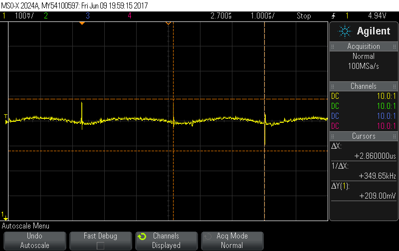

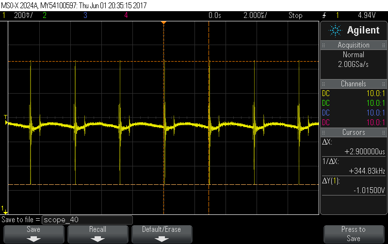

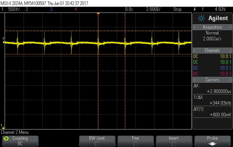

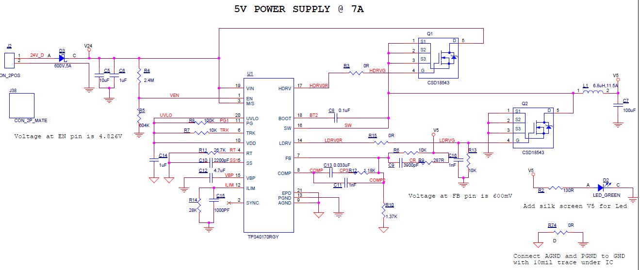

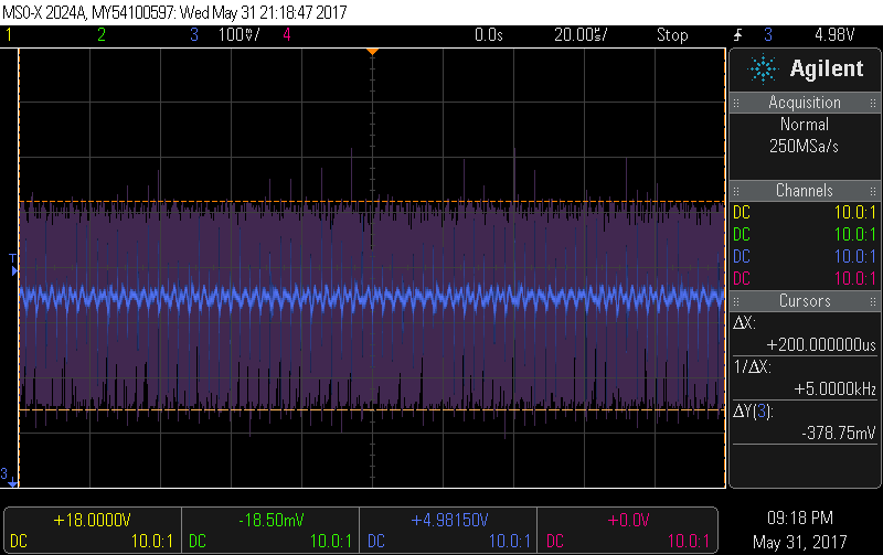

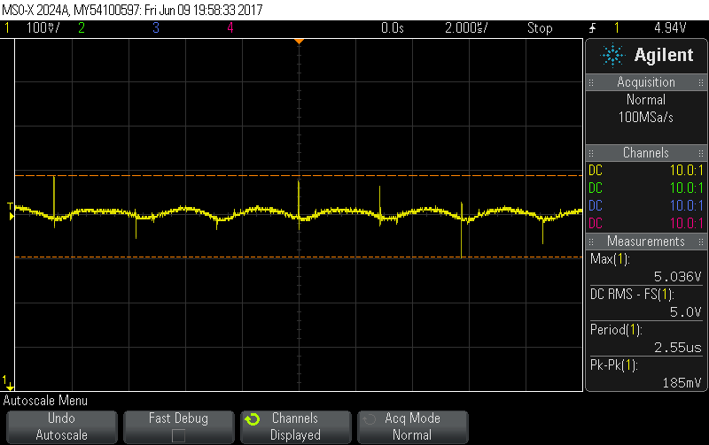

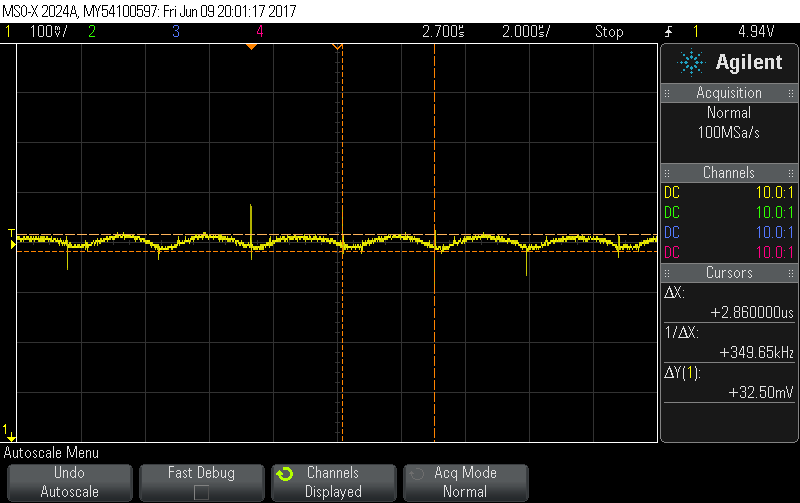

I Designed a 5v,7A power supply from 24v input for my new project. It is giving 4.9v, but have noise issue. When I increasing the load its noise level is also increasing.
I connected 1A load and a rapberry pi at the output. Is it an acceptable level of noise.
I am attaching the schematics and output waveform, Kindly check it and suggest me a solution.
{Note: File names will give the load details.
