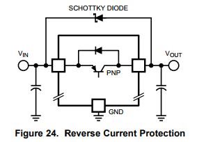

I am using an LP2985IM5-5.0 with the recommended circuit from the data sheet. I have 10V input, 5V out, about 10mA load. I have seen 2 failures where the output voltage is about 6.5V on both failures. There is no oscillation on the failed unit, the 6.5V output is very clean. On a failed unit I measure about .95V on the bypass pin. What are possible failure modes that can cause this type of failure?

    The most likely transient to damage a device is one that causes reverse current to flow through the LDO.  An external Schottky diode placed in parallel with the LDO as shown in section 8.2.2.4 of the datasheet would help protect the LDO from damage in these events.

  • I'm sorry I failed to mention that I do have a Schottky diode in the circuit.
    Is there anything else you can think of that would cause this type of failure?
  • Hi Alan,
    Thanks, that should rule out reverse current. Do you have any inductors on the input or output of the LDO or any long wires in your setup?
