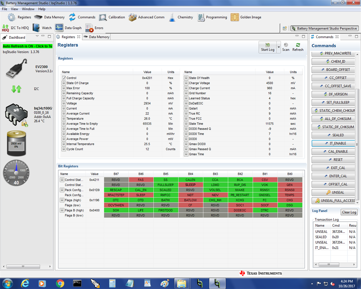

I have a couple BQ34Z100's that I can no longer write to Data Flash Memory.  Other than the device being SEALED and possibly the battery voltage being lower than  Configuration -> Power -> "Flash Update OK Cell Volt", what else prevents Flash writes?  I'm not 100% sure, but it seems to have happened after I executed the "IT ENABLE" command.  How can I regain control over Data Flash Writes?
