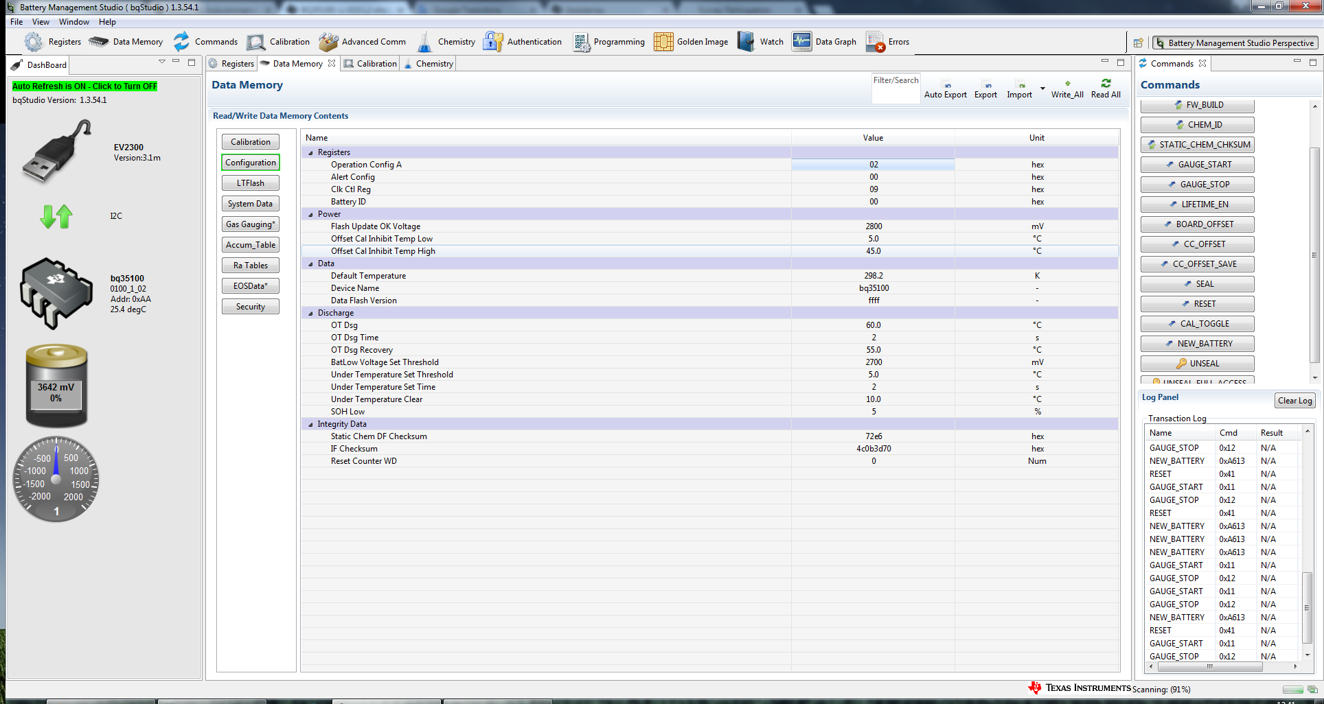

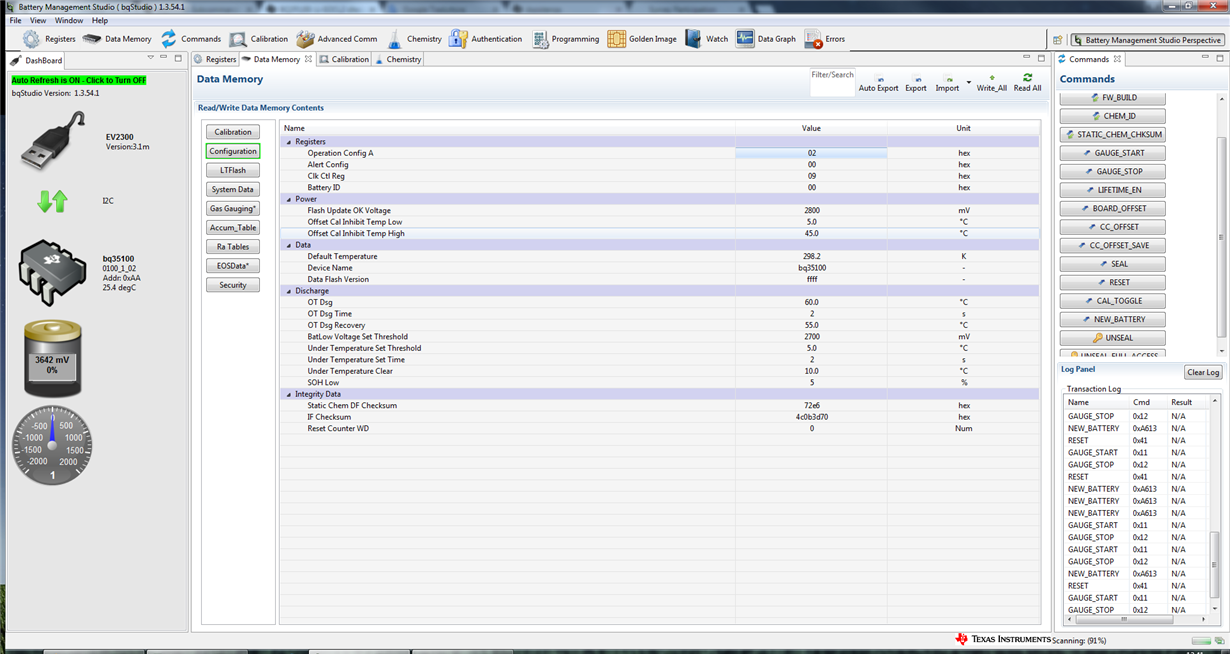

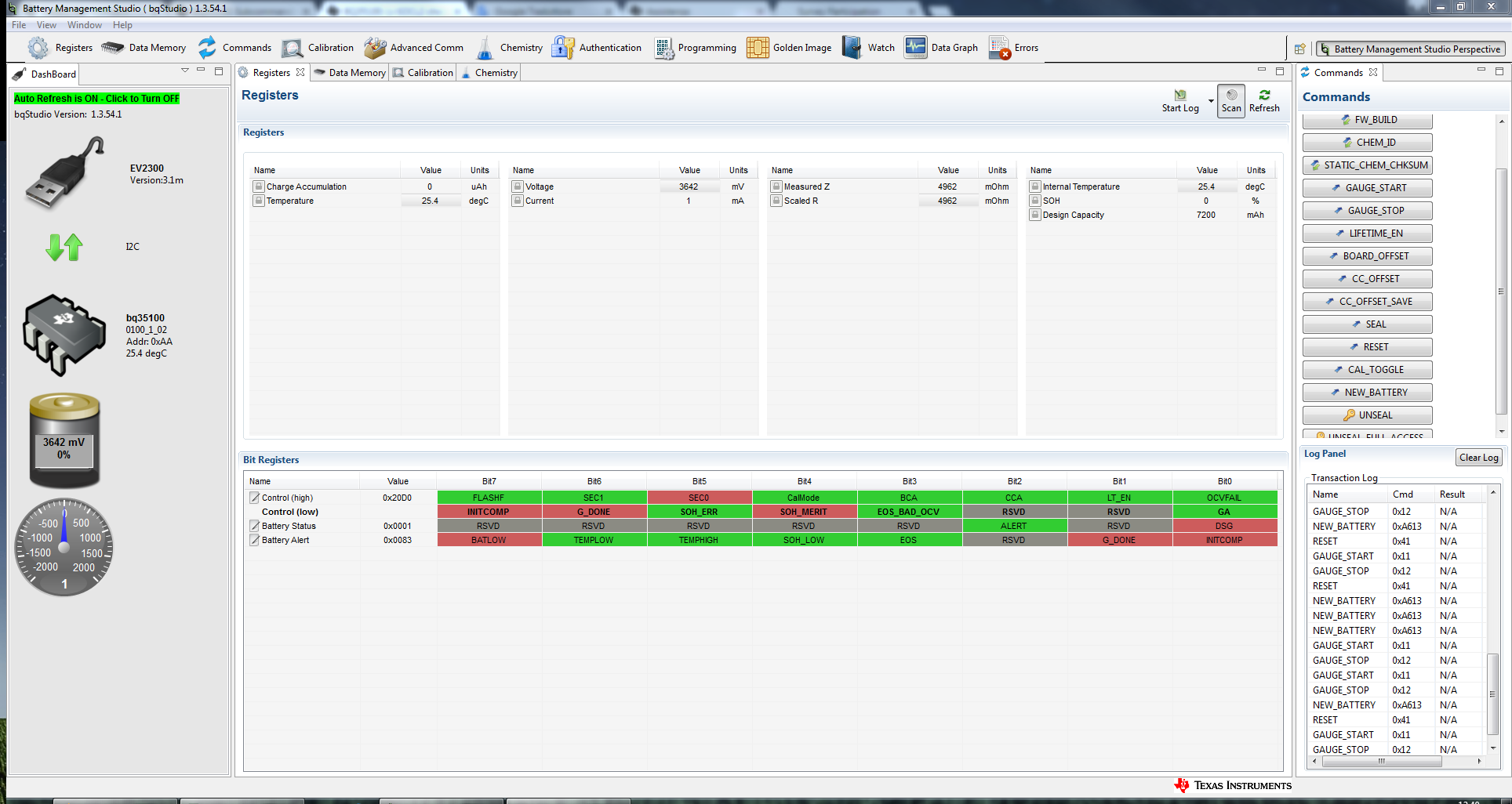

  • I still need help with this problem, I follow all the steps, but the SOH_MERIT bit is set all the time and (if set to 2%) after 50 reads the battery SOH drops to 0%. I attach two screenshot of bqstudio.
  • Alessandro,
    SOH_MERRIT is better named EOS_MERRIT. It comes on when there is a problem in the EOS Impedance calculation. What this means is that during the measurement a voltage was seen that was higher than the initial OCV measurement gethered at the time GE was put high.
    If the cell is not rested the voltage will increase between GE high and Gauge Start. This will cause an error. For future tests please ensure a more rested battery and less time between GE high and Gauge Start CMD. Also be sure the send the gauge stop immediately after the load is removed.
    Let me know if this doesn't help.
    Eric Vos
  • Hi Eric,
    I thought SOH MERIT's claim meant that the SOH calculation had been limited by "maximum health delta status", in fact EOS_BAD_OCV means "that during the measurement a voltage was seen that was higher than the initial OCV measurement gethered at the time GE was put high".
    From my screenshot is possible to see that the SOH_MERIT is set, instead EOS_BAD_OCV is clear.
    From the last tests, the measured impedence is about 2000/21000ohm. But the computation of the SOH is limited all the time.
    In the previous reply, you said "The default values in the gauge are for the LS17500.  So there is no need to update the chemistry.", what do you mean with default value? 0x0606, 0x0607 or other?
    Thank you,
    Alessandro
  • Alessandro,
    Unfortunately the name of SOH_MERIT is a poor name choice. EOS_MERIT is a better name for it. EOS_BAD_OCV means you have a bad initial reading rather than a higher voltage during the pulse.
    If you are getting a different impedance than something is different about your setup and the measured impedance is different than our chem ID. it could be a combination of things, with the most likely a different connection and load profile.
    Are you getting anywhere from 2000 to 21,000? or was that a typo?
    Yes the default chem ID in the bq35100 is the LS17500 cell. As stated above though these cells have anon linear profile and are load dependent. I will open a private thread with you to discuss further actions.
