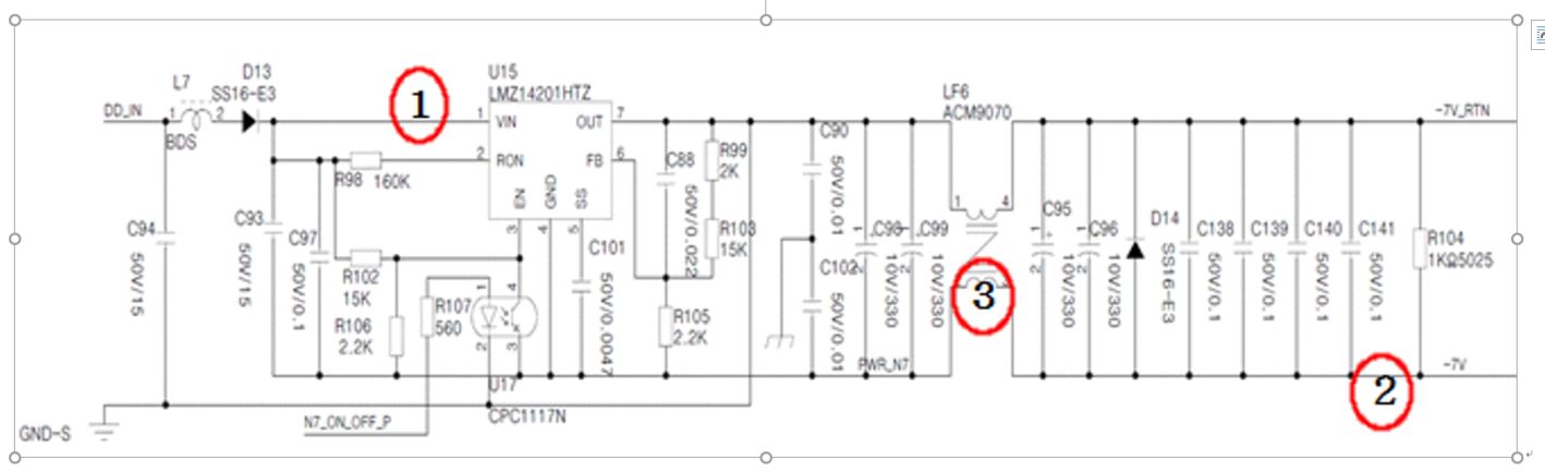

This is -7V Convertor Circuit.
1.  Input Voltage
2. Output Voltage
3. Output Current
Can you Check the Circuit and the inrush Current?
sometimes Damage occurs when power is on.
Regards.

  • Hi Louis,
    I want to confirm that C101 soft start capacitor is 0.0047uF. This should result in a 0.5ms soft start duration and should have reduced inrush current from the input supply since the output voltage slowly ramps to the desired output voltage. In a typical application, the minimum output capacitor follows Equation 19 of the datasheet. For reference the EVM for the LMZ14201 has 420uF of output capacitance.

    Can you check the Output Current when uses negative output?
    Damage occurs only when the my customer uses this product as negative output.
    Can you tell me what you need to be check point when uses nagative output?
    Regards.
  • Hi Louis,
    Generally when using a device in an inverting buck boost(IBB) topology, it is best to look out for the input voltage range and output current. In an IBB topology, the expected output current will be lower than in the regular buck topology. The input voltage range will be lowered since the reference is now negative Vout instead of ground.
    The SLVA514B app note helps illustrate the necessary considerations when configuring a buck converter into an IBB topology. There are also wave forms that you would expect to see for startup and shutdown in this configuration. As for the inrush current spike that results from initial startup, it is still hard to determine where that is coming from.
