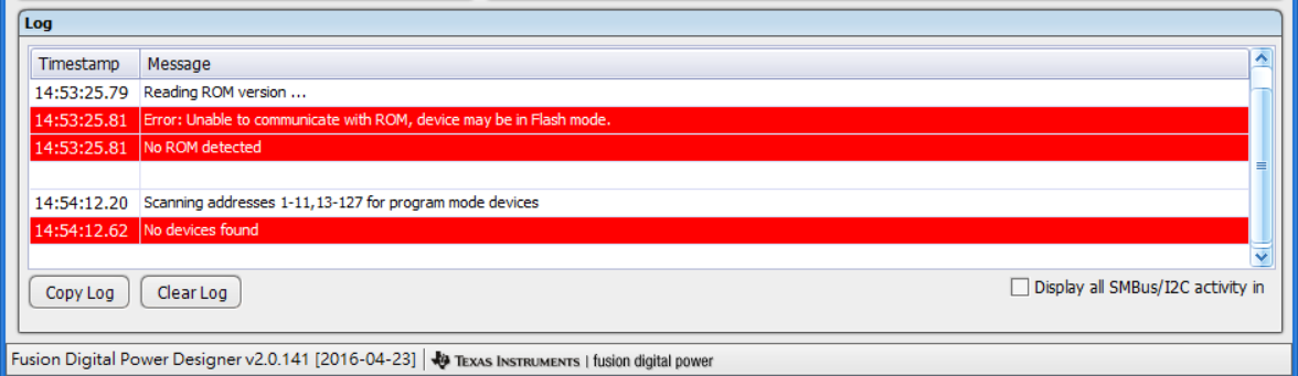

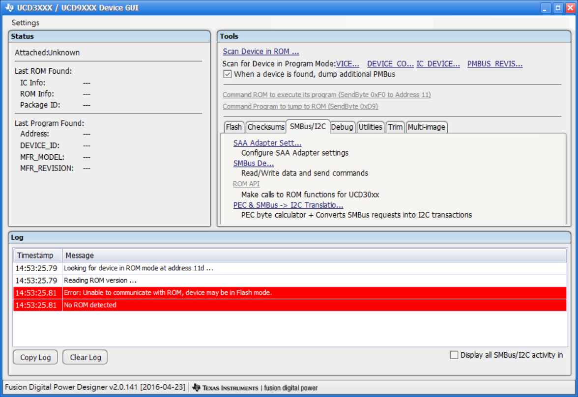

Hello everyone, I have bay the UCD3138A64 EVM622 on TI store, When I use GUI "Scan Device in ROM... " , He can not find the ROM
When I use GUI "VICE... " , He can not find the Devices.

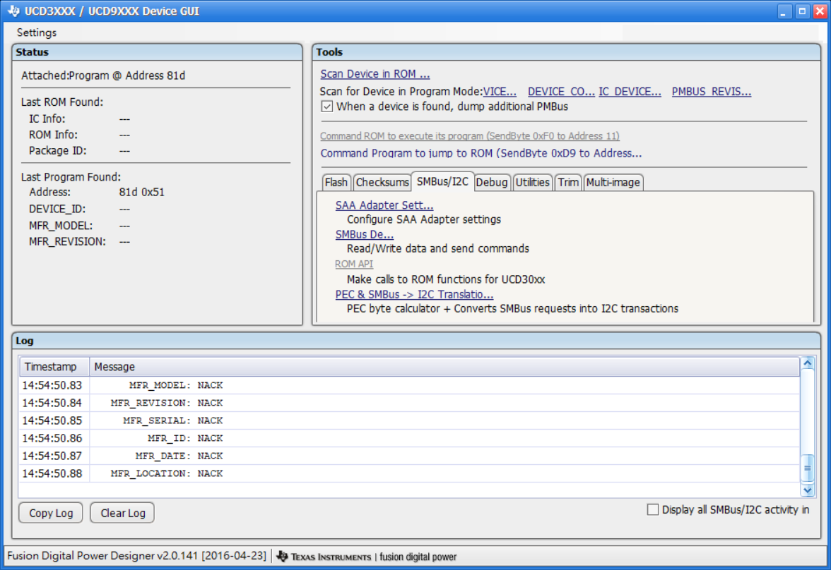

When I use GUI "PMBUS REVIS... " , He has address.
But I use the command 0xD9, It still can not return to ROM.
Please What can I do now?
