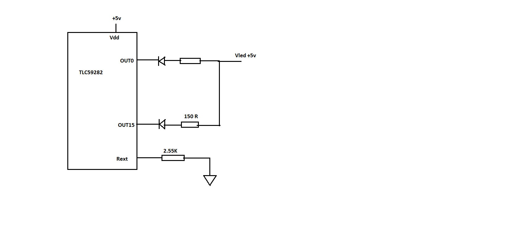

    I have a quick question about TLC59282.
OUT0 to OUT15 ins are for LED sink.
for example if  I have below values:
    Vdd = 5v
    Vled = 5v
    Iref = 20ma
   Rext = 2.55K
  LEDs forward voltage is 2.2v
  Then do I need to add limiting series resistor through LED to OUTx pin of the chip  ?
  Is my schematic attached is correct ?
  • Hi, Winston,
    Your schematic is correct.
    The biggest consideration is thermal performance.
    Considering using 20mA for all channels all the time, the power dissipation of TLC59282 is around:
    (5V-2.2V)*20mA*16=0.896W.
    If using QFN package, the θJA=46.8°C/W, the temperature increase is 0.896*46.8=42°C.
    If the duty cycle is less than 100%, the temperature increase is less than 42°C.
    To decrease the power dissipation, you can decrease the voltage drop on TLC59282 by adding a resistor.
    For example, adding 100ohm resistor can decrease the voltage drop on TLC59282 to 5-2.2-100*0.02=0.8V.
    Thanks.
    Kenneth
  • HI Kenneth,
    Thanks for the info :).
    Consider the scenario:
    LEDs are going to be ON for 1ms. and OFF for 15ms. (refresf rate 62.5Hz).
    which means the duty cycle is 6.25% . Then do you think the series resistor is necessary ?
  • Hi, Winston,
    In such case, there's no need to add resistor.
    Thanks.
