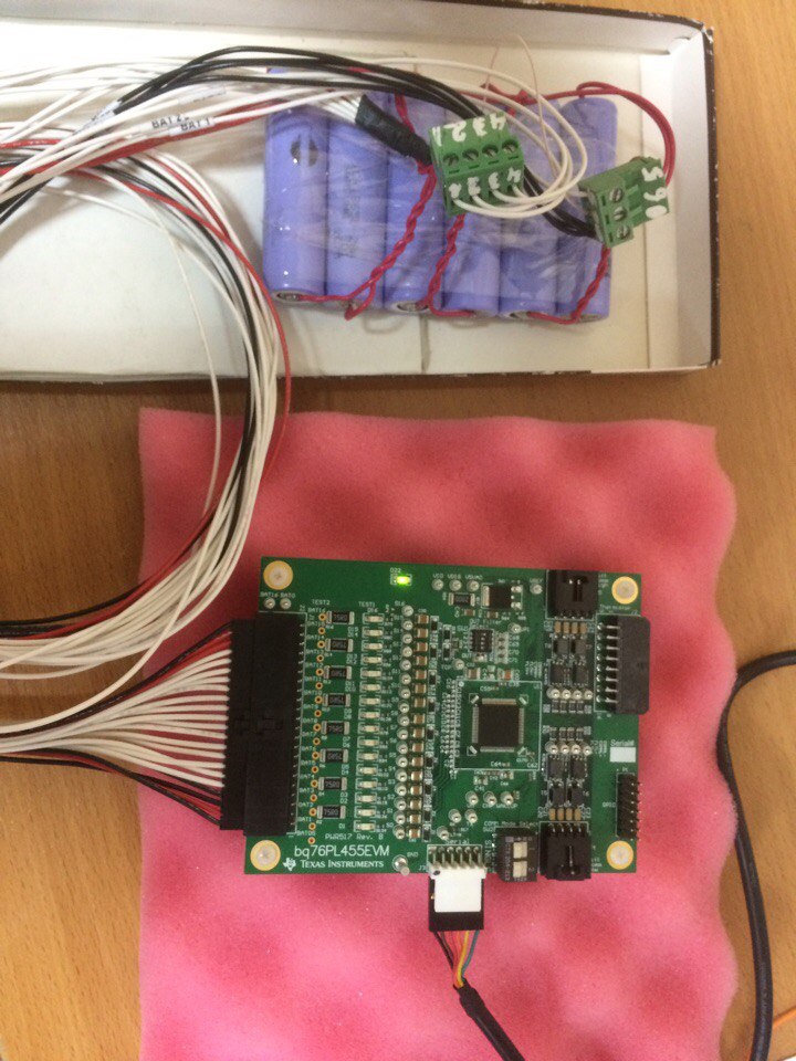

My BQ76PL455EVM not working.

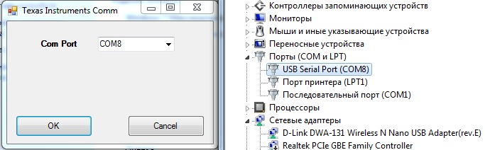

I have checked with the FTDI Settings and tried with another PC.The Same is happening. With GUI im getting "Unable to open com Port" message.
D22 lights up and I measured the voltages on the board as follows.

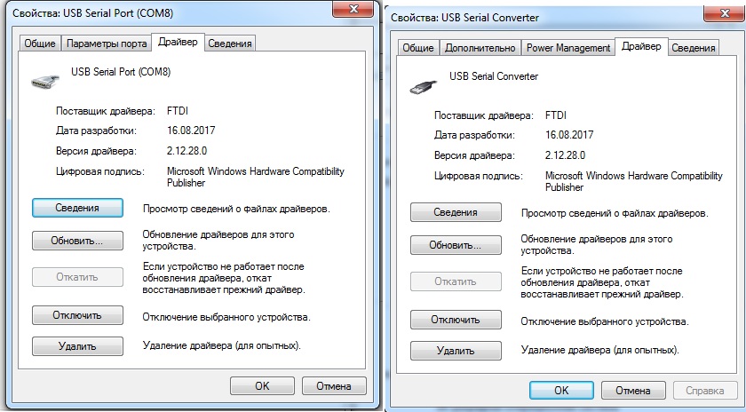

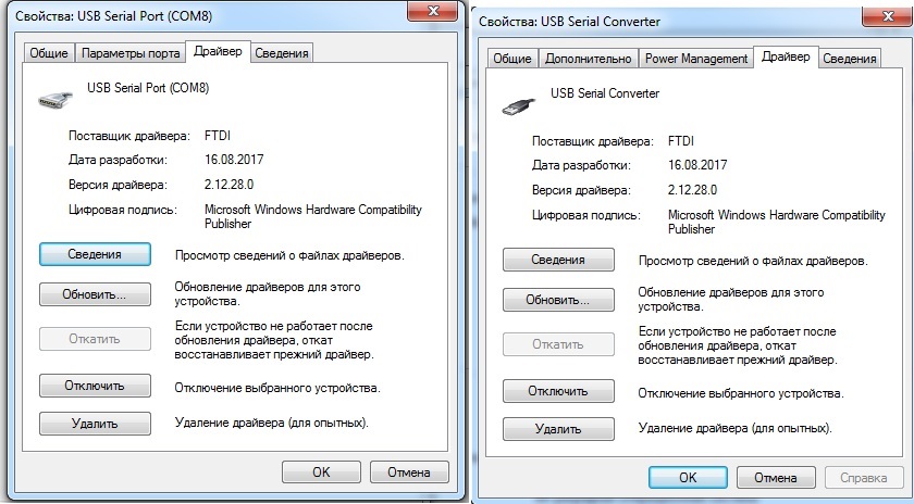

I tried with another PCs and another USB. Driver was downloaded from http://www.ftdichip.com/Drivers/VCP.htm
Did it work?
Do you have another cable to try with?
What operating system were on the PC's? I don't think it should be a problem, but it seems that the board should communicate without issue. Can you send commands through Putty or something similar?
Vbat1 = 4.14
Vbat2 = 4.14
Vbat3 = 3.85
Vbat4 = 3.88
Vbat5 = 3.51
Vbat6 =3.53
Vbat16 =23.42
Hi Raman,
Could I ask you to verify which FTDI driver you have installed?
Just a sanity check, but the voltage measurements were at the IC, correct?
A reinstall of the driver and GUI may be a next step, in case something was corrupted.
It seems like the FTDI driver is not using the virtual comm port correctly if your board is waking up.

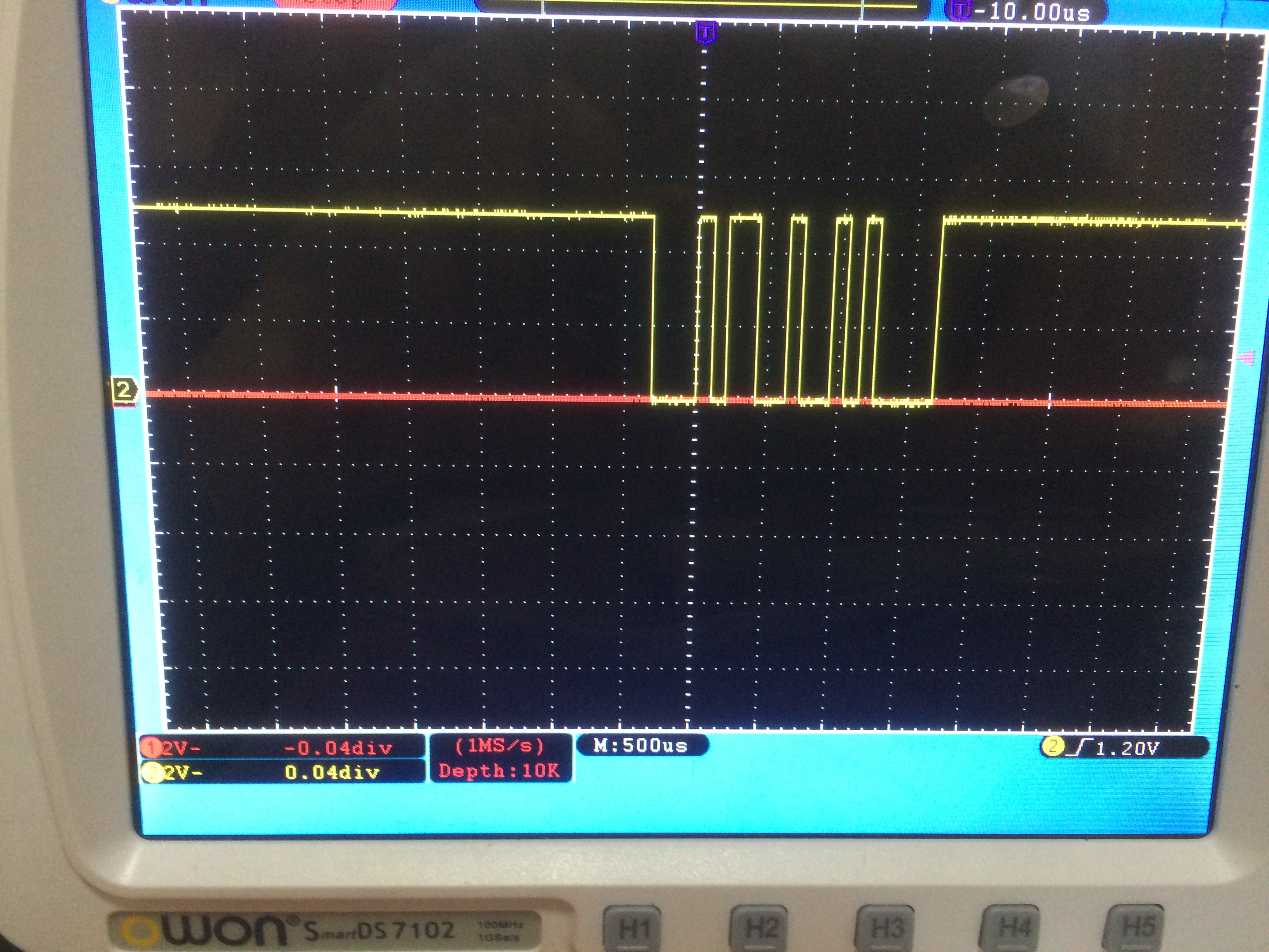

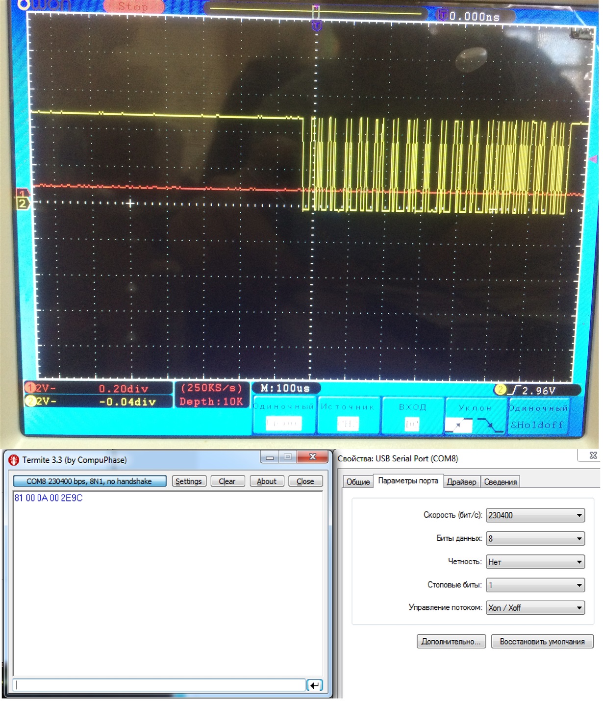

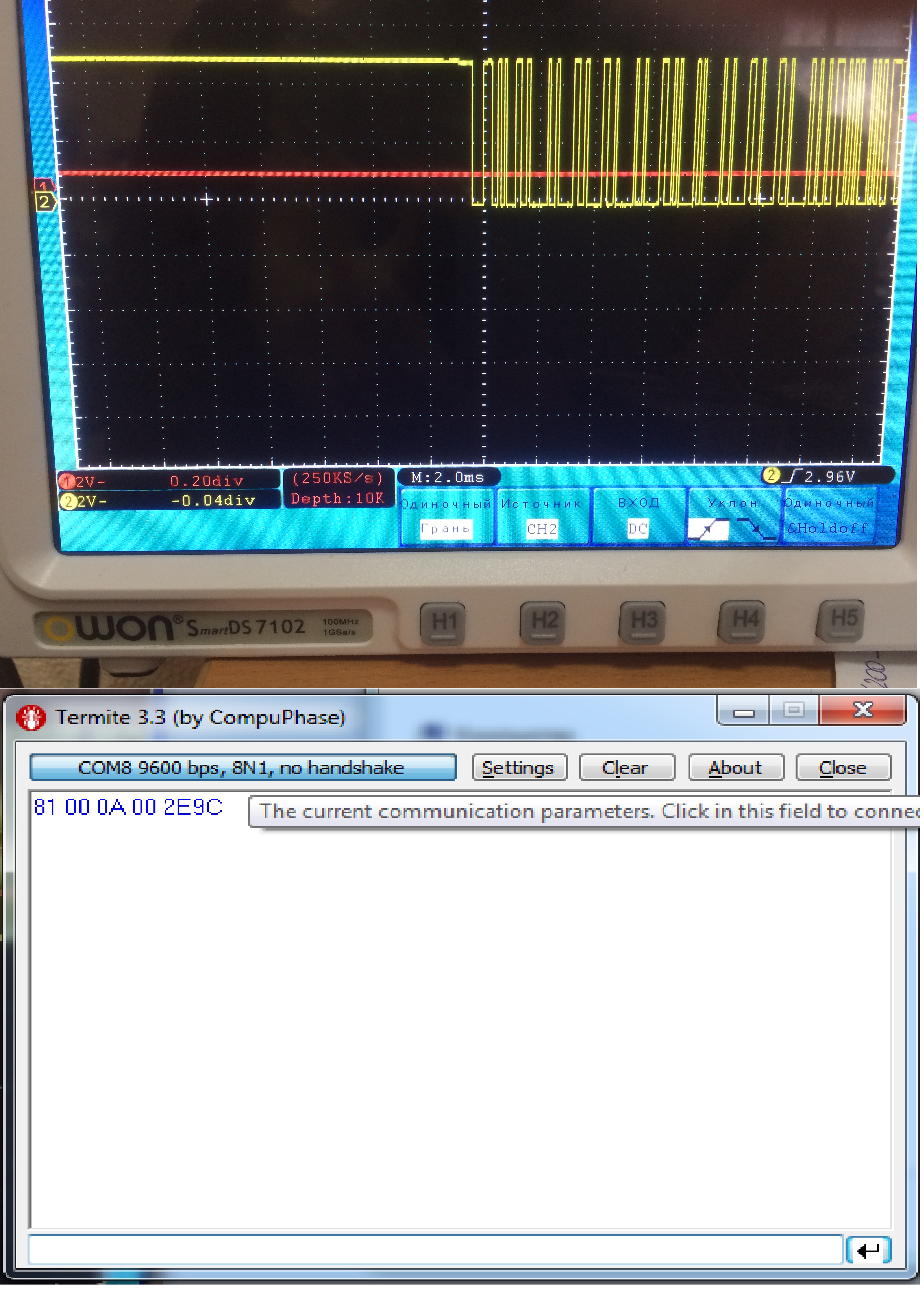

What about SW2 position on board. (SW2 - COMM Mode Select switch package)Specification variat is CTS 204-221, but I get CTS 204-212. These connectors short-circuit different groups of contacts.
Hi David,
The 212 variant not correct for this device. It's connect different pins than 221. If we want connect some emv, it's did't will correctly.
