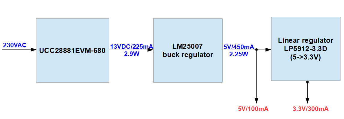

I'm designing a power supply that should deliver 3.3V and 5V from 230VAC. The current rating is 300mA @ 3.3V and 100 mA @ 5V (Maximum values).
My biggest concern is that i have a small area to design my board, so i have to make my design similar to the UCC28881EVM-680 power supply board and the DC-DC buck regulator LM25007 like this one http://www.ti.com/lit/ug/snva152a/snva152a.pdf,
So the idea is convert the 230VAC using the UCC28881 in order to obtain 13VDC/225mA which is equal to a power of 2.9W, and then i have to use another DC-DC buck regulator to drop down the 13V to 5V using the LM25007.
I can't use a linear regulator otherwise i can't obtaint the 400mA current to feed the 5V and 3.3V components.
The 400mA needed from ther 5V is divided in two part, the first 100mA will feed the 5V circuit and the 300mA will feed a 3.3V regulator in order to obtain 3.3V 300mA.
1/ i want to know if the idea/schema is correct ? Can the output of the UCC28881EVM-680 feed correctly the LM25007 DC-DC converter ?

  • Hey Chamkhi Haithem,
    You've got a good amount of questions, I'll format my reply in a Questions Answer format to help keep things clear!
    Q: 1/ i want to know if the idea/schema is correct ? Can the output of the UCC28881EVM-680 feed correctly the LM25007 DC-DC converter ?
    A: This kind of schema is fine and TI has a reference design with a similar idea in mind here: www.ti.com/.../PMP11236
    The power outputs are different but the schema/idea is similar to what you're going for.

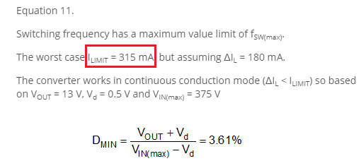

  • THANKS FOR YOURR ANSWER I APPRECIAT THAT,
    one last things that bother me is the output inductor. i had to choose this one which is smaller DR0608-105L ,it has the same inductance of the design which is 1mH , but the current saturation is lower and only 350mA.
    and from what i read in the documentation that you provided me,  the worst case the ILimit is about 315mA which is above the current saturation.
    regards,
    The inductor you chose is rated for 300mA, and at 350mA there is a 10% drop in inductance. That means your inductor value is now 0.9mH under those conditions. I looked at the datasheet calculations and the inductor needs L > 536uH. It seems like your inductor selection may be fine.
    This is assuming that your output is the same as the EVM/Typical Application: 13V. If not, you need to redo your calculations with the desired output voltage.
