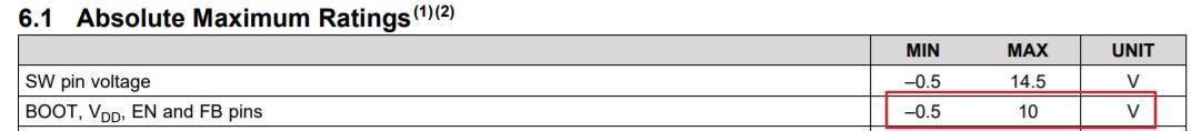

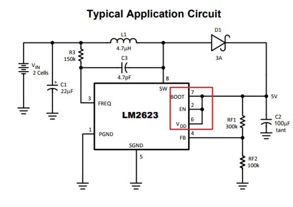

Our customer are evaluating LM2623 in their design, the input is super-capacitor and the voltage is 3V, the output voltage needed is 14V. In datasheet, the typical application is based on 5V output, and the BOOT, VDD and EN pin are connected to output directly. However, the maximum voltage of the three pin( BOOT, VDD, EN) is 10V, we can not connect these pin to output directly, so how should we design? Thanks!
