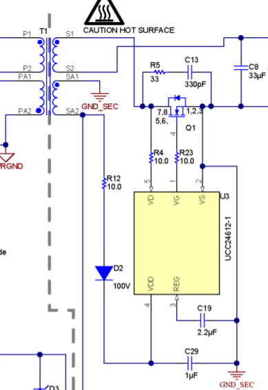

Dear TI,
I want to know the purpose of this winding.
  • Nas
What is the role of this?
Thanks and Best Regards,
BJ Han.
  • Dear Han,
    This winding is for power up the SR controller, as below:
    Also, you can power up the controller from the output.
    Best Regards
