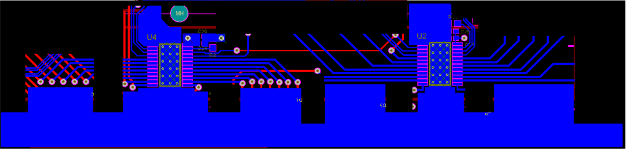

  • Kenneth,
    Thanks for the information, I have included a picture of what I intend to do as far as heatsinking. the vias in the IC center pad are tied to ground. I am driving Cree XLMB cool white LEDs which have a forward voltage max of 3.5V @ 80mA and above. VDD is 3.3V, the LEDs are set 40mA and the forward voltage worst case is 3.5V I am planning on setting the LED voltage to 4 Volts to keep the differential down as much as  possible. Do you see any problems with this approach?

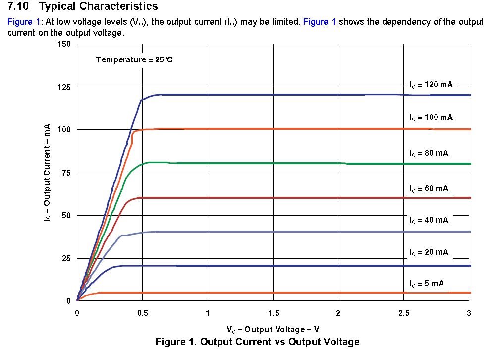

  • Hi, Brian,
    The thermal performance should be OK.
    I have a little concern: as you can see from figure 1 of datasheet, to keep the Iout = 40mA, Vo=4-3.5=0.5V is a little critical.
    Vout>0.6V should be safe for your application. So you may need to increase Vled to 4.2V.
