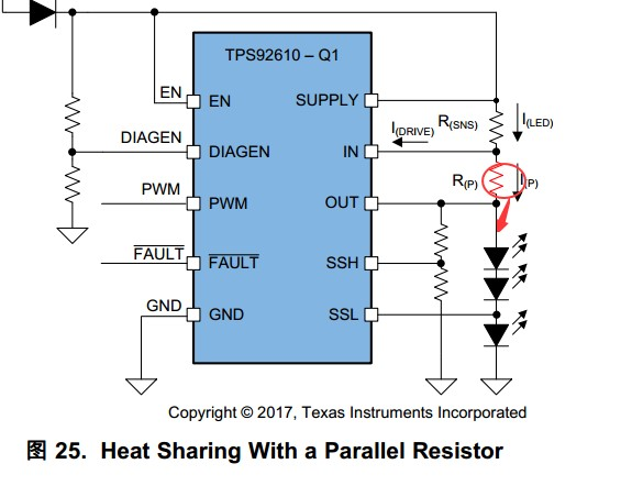

Part Number: TPS92610
Dear TI engineer:
TPS92610-Q1 has the one-fail-all-fail feature.
But if I use a parallel resistor for heat sharing, does the one-fai-all-fail funtion can't work?
Thanks!

Hi Eric,
Yes you are right. The parallel resistor path cannot be shut down if there is any fault.
