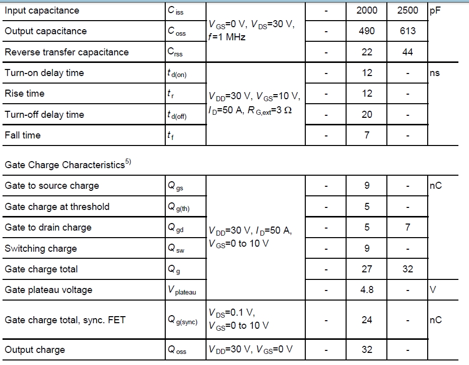

Hi Ti Team
Customer want to design 320W SMPS using UCC28056+UCC25630, and the output is 12V/27A. So customer plan to 2pcs UCC24612, 4pcs 100A MOSFET. One ucc24612 need to drive 2 pcs 100A MOSFET in parallel, Can the UCC24612 driver it directly ? or customer need add totem pole circuit ? The mosfet parameter is as below. pls. suggest.
