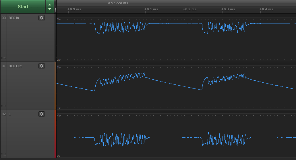

    1. could you measure the Vbat, L and VOUT PIN waveform when you observed issue?

  • Hi Jasper,
    I have taken both the measurements you asked for.
    Yes, here is a scope capture where Vbat="REG In", L="L", and VOUT="REG Out".
    I have three screenshots:
    • Constant draw of 50mA
    • Constant draw of 200mA
    • Constant draw of 500mA
    In all cases:
    • The power supply providing power to the regulator is set to 3.0v
    • Regulator PS=HIGH (disabled)
    • UVLO tied to VIN
    • VAUX 10uF cap to GND
    • VOUT 10uF cap to GND
    Here is constant 50mA draw:
    Here is constant 200mA draw:
    Here is constant 500mA draw:

  • is there long cable between the power supply and the IC? why does VBAT voltage oscillate? you may need to add input capacitor to stabilize the input voltage.
    I swapped the input power source for a pair of AA batteries and similar ripple.  I added a large (47uF) cap and that did smooth the input more.
    However, the fluctuations on the L and VOUT pins remained chaotic.
    What else can I do to diagnose this?
    At the moment I am testing on a breakout PCB for the regulator, as opposed to the genuine product I built using the regulator before.
    For my breakout, I am using the correct inductor (2.2uF power inductor 1.2+Amps), but my output caps (10uF) are electrolytic instead of ceramic.  However, the waveforms I'm seeing in my test setup match what I saw on my PCB when using output caps of ceramic (10uF).
    Layout of the components near the regulator was stated to be important, which I have limited control over in my test setup.  Also, since I see similar waveforms on my PCB, I don't assume layout is to blame because it's so different.
    Can you think of most-likely issues which can affect this?
    Do you agree that the performance I'm getting from the regulator is not what I should expect and that there is some issue?

  • yes. this is not expected behavior. there should be some issues. could you share your old PCB and current PCB?
    i would also suggest you apply an EVM for reference.
    please note that do not use electrolytic capacitor instead of ceramic cap.
