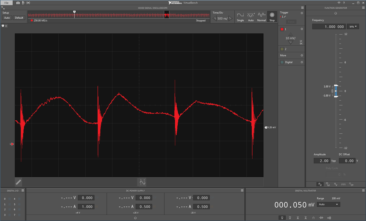

  • Here is the scope screen shot on inductor  current response when I do the load transient test.
    Yellow channel is connected to a the current probe, 10mV/1mA.  Red channel is monitoring output voltage transient with AC coupling.
    Image below shows that  inductor current changes from 40.6mA to 251mA when load changes from 28mA to 188mA.
    Image below shows that  inductor current changes from 40.6mA to 326mA when load changes from 28mA to 244mA.
  • I have looked at the inductor waveforms with different loads. Some waveforms look good. They are similar to what I see on application note SLVA059A. But some of them are slightly different. Please see scope screen shots. A 0.47 Ohm shunt resistor is used to get the current waveform.
     Inductor current waveforms with  28mA load, scope screen shots:
     Inductor current waveforms with  244mA load, scope screen shots ( AC coupling ):

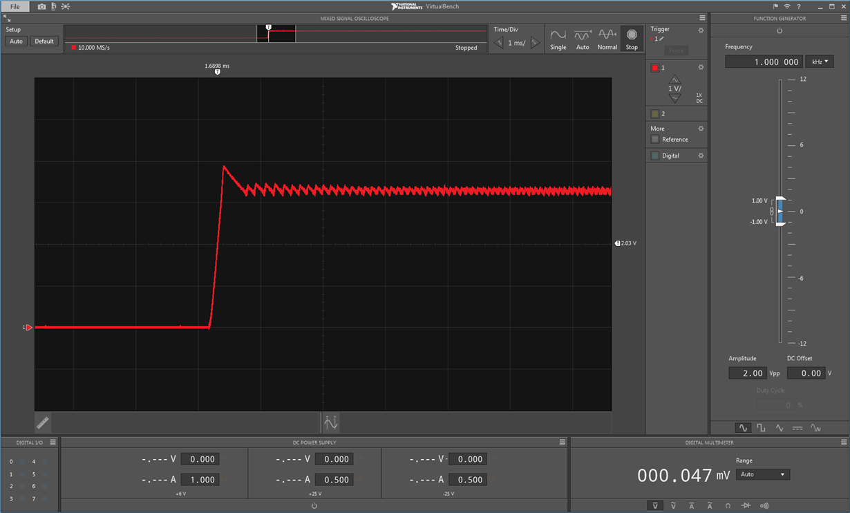

  •  I put those waveforms in Microsoft Word and  past it here. it works!  Please see the waveforms that I captured yesterday.
    They are startup waveforms with different Rc and Cc within suggested ranges. All the waveforms are with 28mA load current, Vin = -12V.
      1. Startup waveforms with Cc=4.7nF and Rc = 20k
      1. Startup waveforms with Cc= 4.7nF and Rc =10k
      1. Startup waveforms with Cc= 4.7nF and Rc =5k
      1. Startup waveforms with Cc= 2.2nF and Rc =10k

  • Here are Jake's waveforms:
    1. Cc=4.7nF and Rc = 20k
    2. Cc=4.7nF and Rc = 10k
    3. Cc=4.7nF and Rc = 5k
    4. Cc=2.2nF and Rc = 10k
