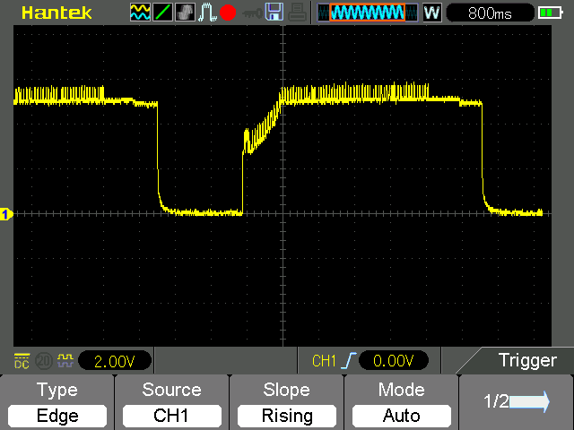

The on the RECT pin is constant at 5-6 V depending on the C1 and C2. C1 I chose to be 330 nF, C2 4nF.
The output does not deliver anything. Any idea what it could be? If I replace the coil with the old one everything works just fine.
Signal on RECT pin:

    Voltage on RECT pin:
    What exactly determines that the device starts? Could it be that the coil can't deliver the current? I set it to be 200 mA. RILIM around 1.3kOhm but did not change the fact that it is not running.
     I would appreciate any further hints.
    Kind regards
  • Double check the voltage that RECT is increasing to-- it should be 7V, but I think it is only about 5V.
    You see Signal Strength, ID and Config at the start, flat area at start (freq fixed at 176kHz).
    This goes well and unit moves to power transfer phase and the voltage at RECT needs to be increased to 7V.
    The voltage rises under the request of the RX.
    But appears to stop at about 5V---The system may run out of gain.
    Then it sits there the RX is sending packets, possibly asking for more power.
    If the voltage does not increase to 7V target the RX will stop trying (packets stop) and the TX shuts down.
    Is the time from last packet to TX shutting down 1.5S?
  • It is 1.2seconds.
