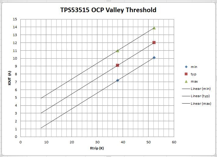

We got a question from the customer about TPS53515.
Could you help us?
[Question]
- Regarding Iocl, they think there are big gap between caluclated value by equation (4) in datasheet and EC table. Please refer to below table. Which is correct, equation (4) or EC table?
- How much is the variation of Iocl at Rtrip=20k? They don't need guarantee. They will use it as reference.
