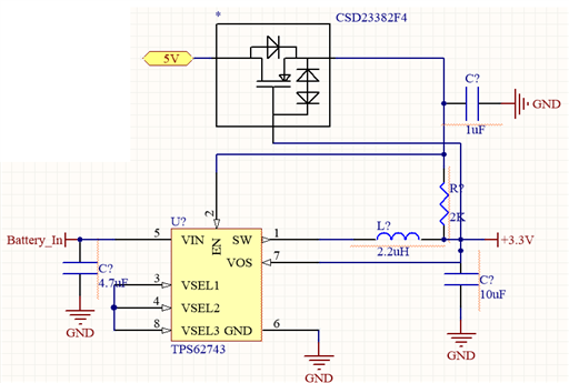

I am working on a wearable and looking for a shipment mode design. I saw the article used in battery management part of my device. I do not use button, I want to wake up with external 5V from my charging device. Schematic is look a bit messy but actually same design in article. Also TPS62743 consumes 7nA in shutdown mode which is less than TPS22915B, am I wrong ?
Thanks for your replies.

    Thanks for reaching out on E2E. For this small battery application, I recommend taking a look at the TPS22916 instead of the TPS22915.
    The TPS22916 has ultra-low quiescent current and shutdown current for extending your battery life. Taking a look at the TPS62743, the device consumes anywhere from 360nA to 1800nA depending on the output load, whereas the TPS22916 consumes roughly 500nA - 1000nA. For shutdown current, the TPS62743 consumes anywhere from 70nA - 1000nA depending on the load. The TPS22916 consumes 10nA - 100nA.
    The TPS22916 is also offered in a small WCSP package (0.78mm * 0.78mm).
    Let me know if you have any additional questions!
    Arthur Huang
  • Hi User,
    Typically, ship mode would be taken care of by the battery charger such as bq25120. Then, the DC/DC would connect to PMID and not to the battery directly. With this architecture, there is just one leakage path from the battery (in the battery charger) during ship mode instead of into every device on the PCB.

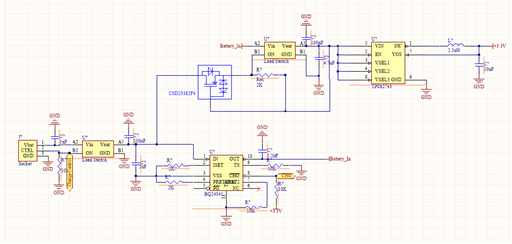

  • Thanks for your reply. Ok I will use TPS22916 then I have another problem. I need to control current flow through charge socket to BQ24045 on the board. So same pin in charge socket will reset shipment mode and open BQ24045 input path. I attached my design. Is it wrong ?
  • The BQ24045 will work well in a ship mode configuration, with Vin =0V the quiescent current will only 1uA. Configuration of the BQ24040 looks good.
    Have not reviewed the ship mode switch circuits.
